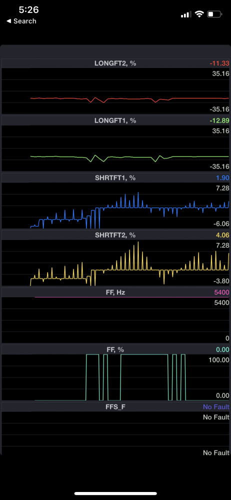

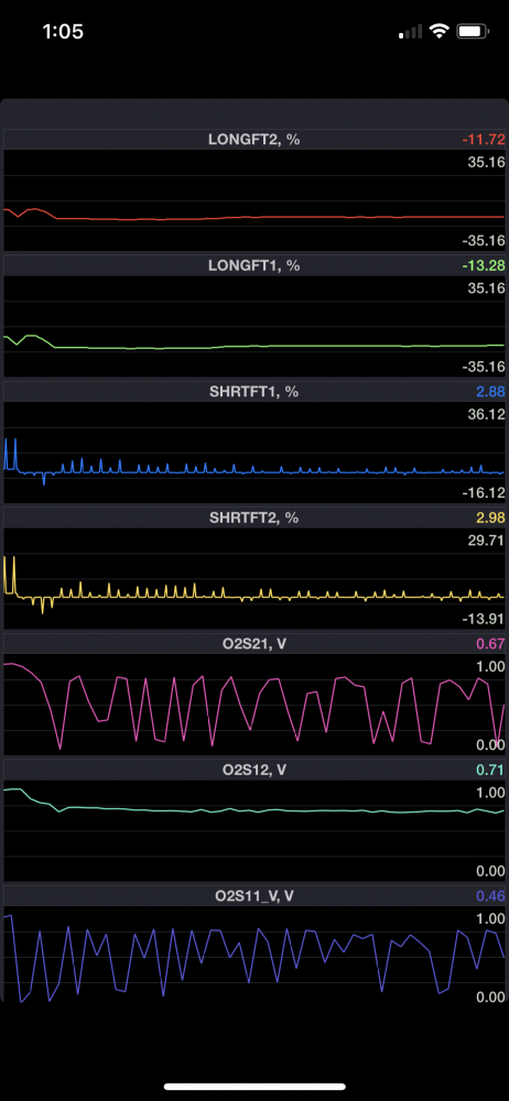

Driving at cruising speed -

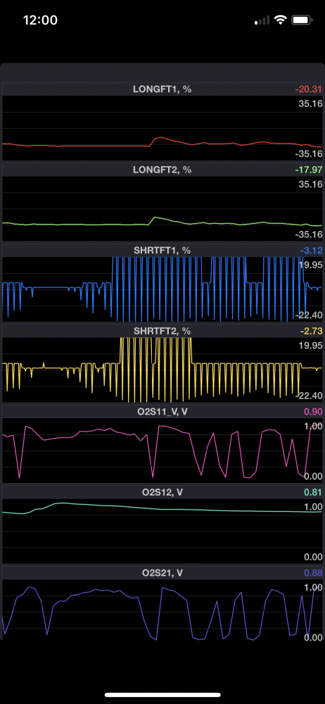

After exiting freeway and sitting at idle:

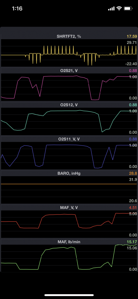

WOT in 4th gear-

Do you have an FF_inf (Flex Fuel Inferred) or similar PID available showing the calculated alcohol percentage in the fuel?
If that number is skewed high it will be running rich and thus have very negative long term fuel trims.
I have FF Hz, FF% and FF Status. FF Hz stayed stuck at 5400 and FF% stayed stuck at 100% unless I blipped the throttle. Sensor shows no fault. I run 87 octane currently.
I guess I need to dig into the FF system.

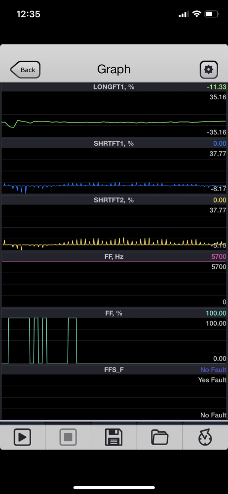

I pulled another flex fuel sensor from a Ford Taurus today and the replacement unit now reads 5700 constantly vs the 5400 constant that my original unit did. Are both of these bad??
I cleaned the connectors for the sensor and the main body connector but no changes happened.

Test drive the truck at WOT and watch your 2 upstream oxygen sensors. If they drop lean at WOT , there is a fuel delivery problem. If your oxygen sensors stay rich, above 800 mv. at WOT, then fuel delivery is good, you most likely have a plugged exhaust.
The upstream sensors go to .88 mv at WOT.

I still suspect the flex fuel sensor might be the culprit. I'm reading that typical sensors read 50-150hz and two different sensors have showed 5000+hz. I cleaned the wiring and verified that disconnecting the Flex Fuel sensor throws a CEL, so the wiring appears to be good.

I also have started to believe that the Flex Fuel sensor is operating properly but the PID is missing a decimal in FORScan. This article shows that most composition sensors operate between 50-150hz and my sensors were reading 5400 and 5700, which if we infer that this is 54.00 and 57.00 is within spec for fuel with a slight ethanol content. https://www.hpacademy.com/blog/how-to-find-out-what-percentage-of-ethanol-is-in-your-fuel/

I verified the BARO sensor is working and reporting proper inHg and is pulling 15lb at WOT which seems accurate for a 3.0L according to some calculators I checked online. You can see the BARO PID in my original post.
