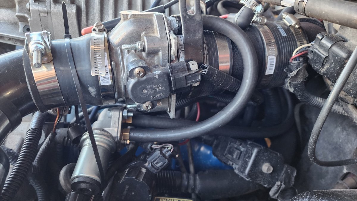

I am experiencing a similar issue with high idle.
  • At cold start, the idle is around 1000rpm.
  • After a few minutes of warmup, idle is 1250 - 1500rpm.
  • IAC replaced on old engine and idled correctly @ 650 - 900rpm. Only 2000 mi on IAC.
  • Unplugging the IAC makes no difference in idle.
  • Pinching either line running to the IAC stalls the engine.
  • Have sprayed starting fluid around every vacuum and intake fitting. No vacuum/fitting leaks.
I can pinch the line because this is a custom application with a supercharger. (See pic)
