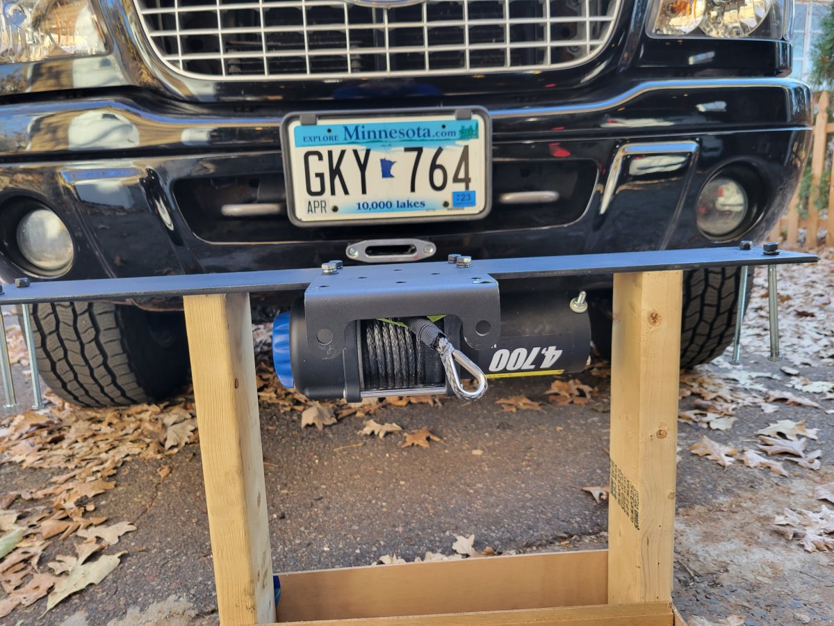

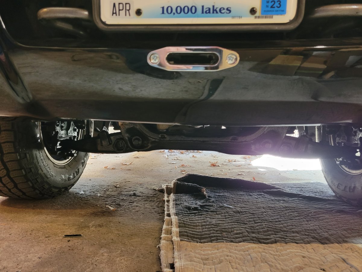

This little idea isn't for everyone, but it works well for me. i don't go off road, try to ford raging rivers, or climb over rocks. I do need to use a winch every once in a while, maybe once or twice every couple of years. The situation is always the same. I pull someone who is stuck in the snow, on more or less level ground. Or maybe even, I have to pull myself loose. A new off road bumper with a heavy duty winch would be overkill.

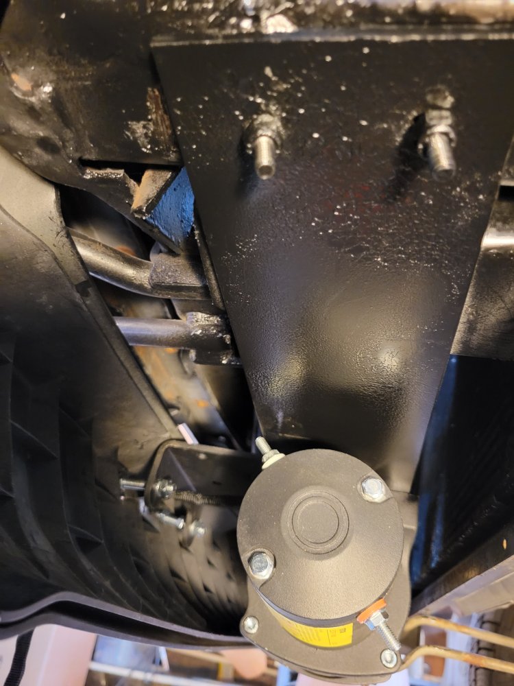

I chose to install a hidden winch instead. The one I chose was rated at 4,700 lbs, more than enough for my purposes. My Ranger reg cab weighs in at 3,000. I mounted it just behind the front valance, bolted a 4'' wide chunk of steel to the frame just in front of the radiator. I reinforced the valance just behind the fairlead. and bingo, everything came together.
Actually I've used it twice already. Works like a champ.

The fairlead is bolted to the valance, but those same two bolts are also fastened to the mounting bracket in order to support the fairlead and the valance. I had a plan B in mind, but didn't seem to need it.
BTW: This was once a Ranger Edge which did not come with tow loops. I've installed a couple I found at the Upull yard just in case I need more pulling power. So if I should ever need to yank real hard, harder than 4,700 lbs, i've got that option too.
