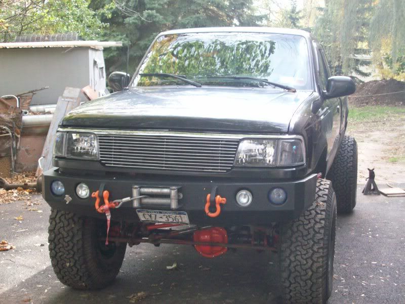

Hey has anyone ever made a hidden winch mount for their truck if so how did you do it? also any pics would be great
heres mine fits between the frame rails..
Check my avatar pic, slovo built the bumper but the winch sits in the grill valance.

I built this one recently on my 2003. It's 6x1/4" flat bar with some 1/4" angle on the front that the fairlead mounts to. It has 4 grade 8 bolts holding it to the frame. I was able to fit a 9500lb Superwinch with a little bumper bracket and valence trimming.
