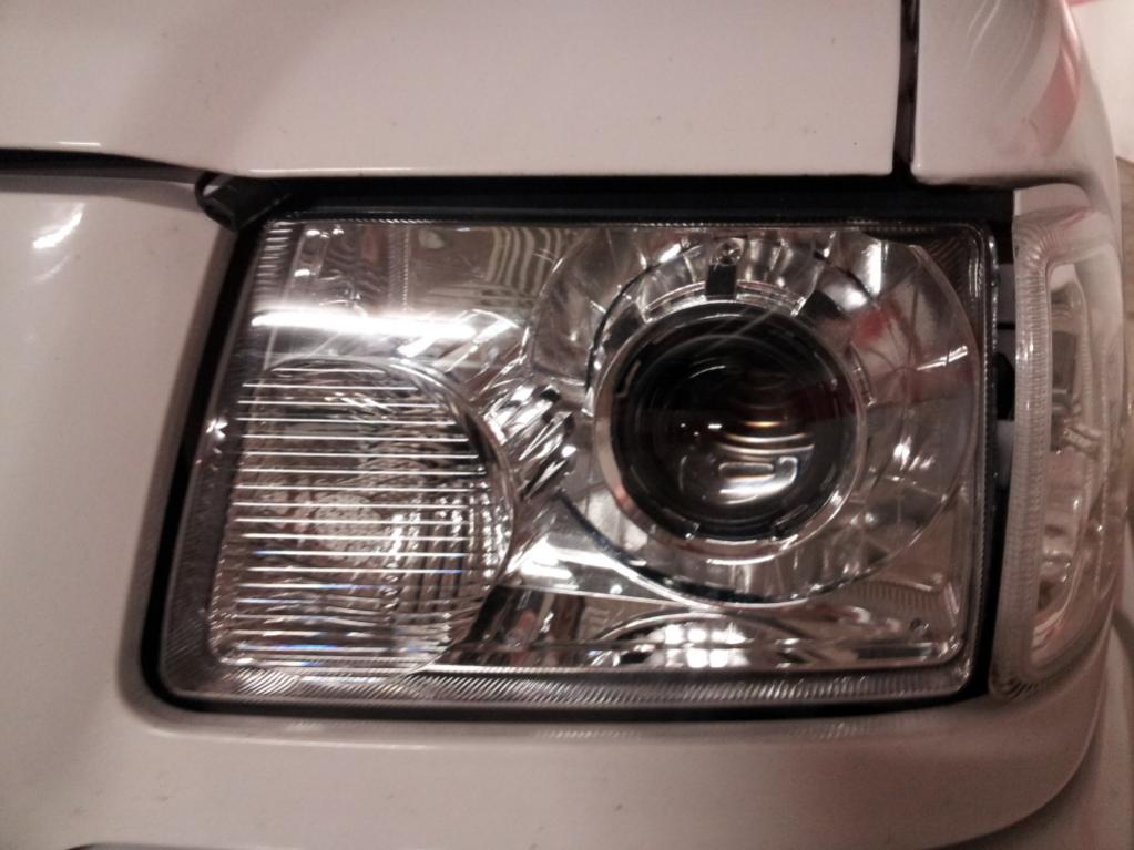

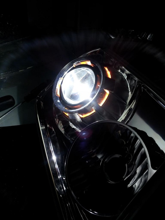

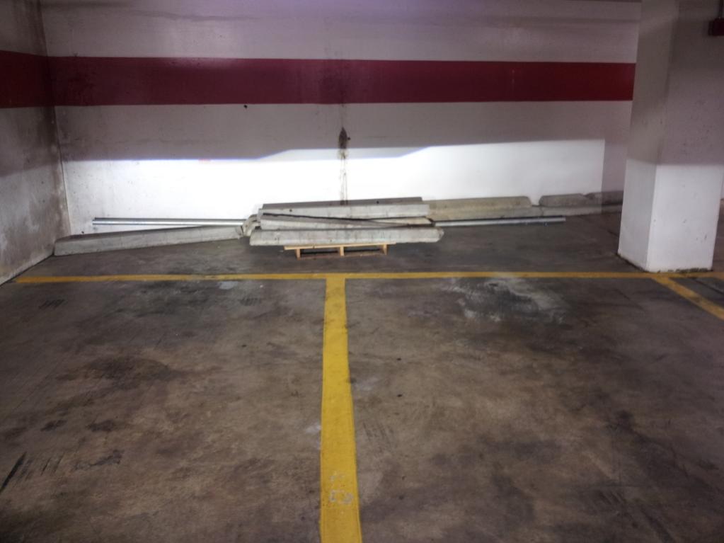

I did my retro fit back in 2012 using Mini d2s. These are old pictures but I don't think it looks like ass at all.
If anything you could grab TL projectors. They are excellent. s2k projectors are in my STi and they are by far superior to anything that came out of the Subaru's factory...lol
Most purpose made kits that are already made are cheap ebay assemblies that have horrible quality projectors with crappy cut offs.
I plan on doing another retro and either using Mini D2S but the 4.0 version.
