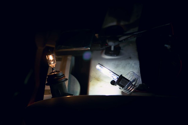

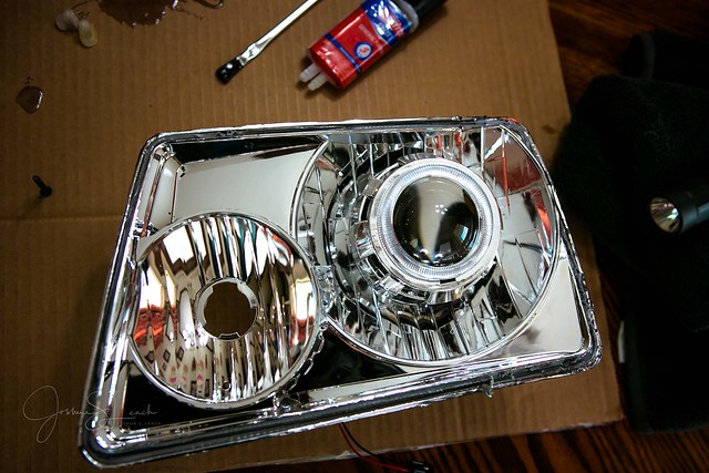

Finally got to this little project. Took about 2 hours not counting cure time.
Opt7 35w blitz kit with some mini H1 style projectors.
Ranger HID Headlights-7 by Josh Leach, on Flickr

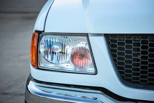

Stock lights

Projector mounted.

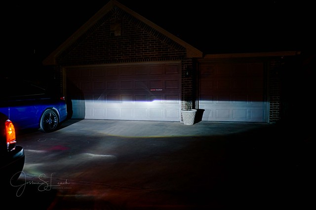

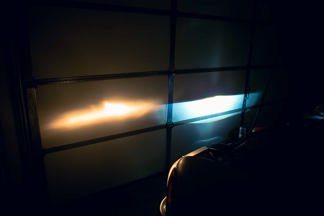

The different is significant to say the least

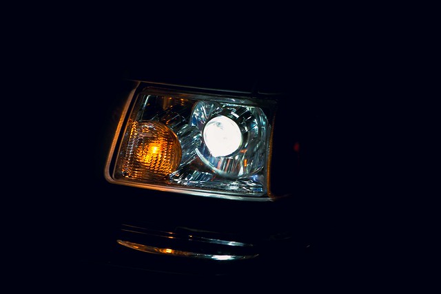

Ranger HID Headlights-16 by Josh Leach, on Flickr

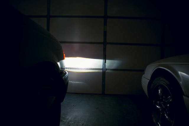

stock v. projected
Ranger HID Headlights-18 by Josh Leach, on Flickr
Ranger HID Headlights-20 by Josh Leach, on Flickr

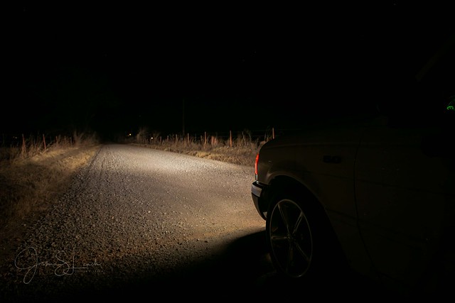

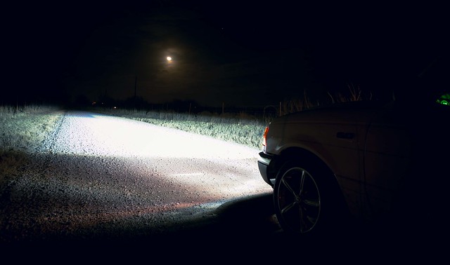

Projected down a dark road.
Ranger HID Headlights-21 by Josh Leach, on Flickr
Ranger HID Headlights-22 by Josh Leach, on Flickr

Both shots were taken with the exact same camera settings to illustrate the vast improvement of light.

If it washed out the picture won't it wash out your vision too?
Well, it is quite hard (maybe impossible?) to get a camera to capture an image exactly like how a human eye sees it (leaving the camera on it's automatic exposure settings helps, but it's still not an exact replication).
However, judging by the quite bluish tint of the HID making the halogen look so yellowish, I'm guessing you must've bought 6000°K (or higher) bulbs, which is probably the worst thing you can do, short of going to LEDs.
Most (if not all) OEM HID headlights are closer to the 4000-4500°K range, which your eyes see much better with at night than 6000K, not to mention will create less glare for others too (no, artificial light sources are NOT anything like sunlight regardless of how close the °K rating may be to it... This is due to the spectral output distribution of artificial light sources (other than halogen incandescent) being very different than that of the sun's light).
Keep them aimed properly (and don't haul anything heavy in the bed) and you'll probably be OK in regards to blinding others (I do see a proper (if a little sharp) beam cutoff pattern, similar to many OEM lights). If others start flashing their brights at you though, then you'll need to aim them down lower.

They look blue in the turn out but thats mostly my camera. I do a lot of photography and I have my camera set up almost in a blue/gray scale. They are 5ks.
I aimed them after I took these shots and its pretty cut and dry now. Went for a drive and didn't get flashed.
