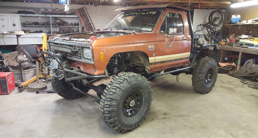

Did a 3 link and full width conversion on my branger and wanting some input on how everyone set up their custom hi steer brackets. I have a Dana 50 up front.

What year of Branger? I want to do this with a Dana 60 and a 98 in a few more years. Nice work.
Don't know how I missed this thread - I think your best option is to have your knuckles machined and drilled/tapped for high steer arms. Just be aware that it's going to screw up your track bar angle but that's an easy fix.
