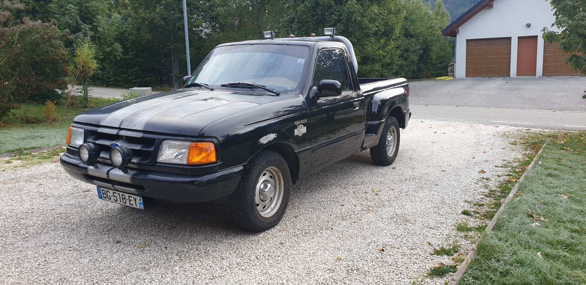

I'm the new owner of this Ranger "Splash" 1995 since november 2018, 2.3l SOHC in, imported from Canada a fews years ago.
It's been paint by an old owner, who just destroy the look of it... Hate dat look but well... It's on now. It was Yellow basically
Actually no more rollbar, black band on top of the windshield, no more added lights.

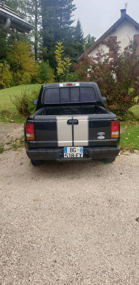

I do have fews issues with.. some electronics problems from the owner before me who was a real a**hole, the chassis is a little bit bent, but it doesn't change the way the truck ride, so I think i'll let it like that. It will cost me more than the price I bought the truck to get the chassis fixed (from behind you can see the right side of the bed is lower, pic on)
If someone know how I could get my tailgate centered?

This was the day I add it back home:

Unflat bed ahah

Take a look at the body to frame bushings. Maybe you can shim the low spot.

Have you checked the leaf spring hangers.... Those are common to fail and just about all those 90's rangers needed them replaced after 5-10 years. That license plate is HUGE. Could serve a turkey on that thing.
All the mounts, shocks and bushings from the suspension system need to be replaced. So yes I hope it's one of those. But when I removed the bed the other day, I've tried to check but no one look really bend or anything, just pretty rusty ahah!

The tailgate is an easy fix. The part you need is called a Tailgate Hinge Insert Kit, they are less than $10 US dollors. Little plastic pieces that fit into the hinge of the tailgate keep it centered.

Thanks!! Gonna be good to get it fixed!
