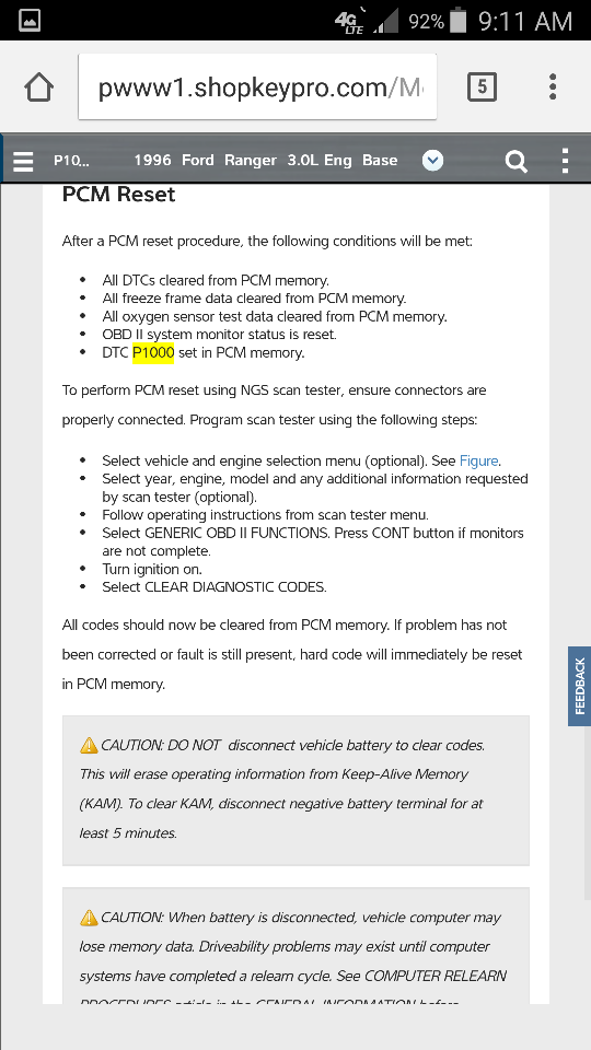

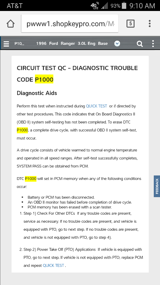

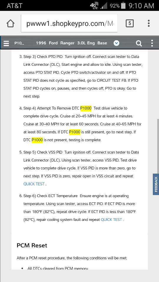

P1000 is the pcm lost power or CAN didn't sync
