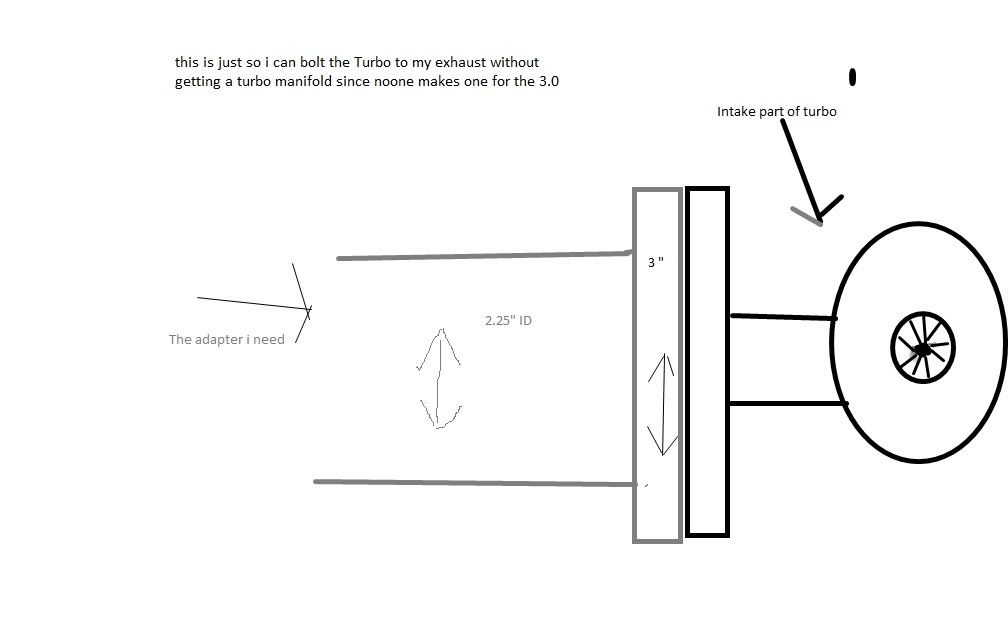

see I'm not sure about how thick i need it to be thats why i was askin you all, because there are people on here that know what i need. but yea square to round. To get an idea of measurements i was plannin on usin a T3/T4 hybrid turbo.
http://cgi.ebay.com/ebaymotors/T3-T...ptZMotorsQ5fCarQ5fTruckQ5fPartsQ5fAccessories
this link will have the measurements of the inlet on the turbo
as far as the bolt hole dims idk .
if you can get a set of gaskets for the two sides that ned to be adapted, that should be sufficient. gaskets are usually very cheap.
hopefully this will give you all a better idea of what i need
i know exactly what needs to be adapted but the gaskets let you know where they bolt together and how much you can port it out to to get a better flow. ive done this before on a twin turbo setup. the guy trusted me with 2 $2300 turbos that he bought from japan for his 300zx.
If I understand correctly what you are proposing, how do you plan on returning the oil from the turbo to the pan? as they will be at the same level.
I was thinking of making a remote oil reservoir and a remote cooler and pump for the oil, it will prob be a PITA, but i dont have to figure out how to make it return to the pan. That is what one guy did that made a remote turbo.
