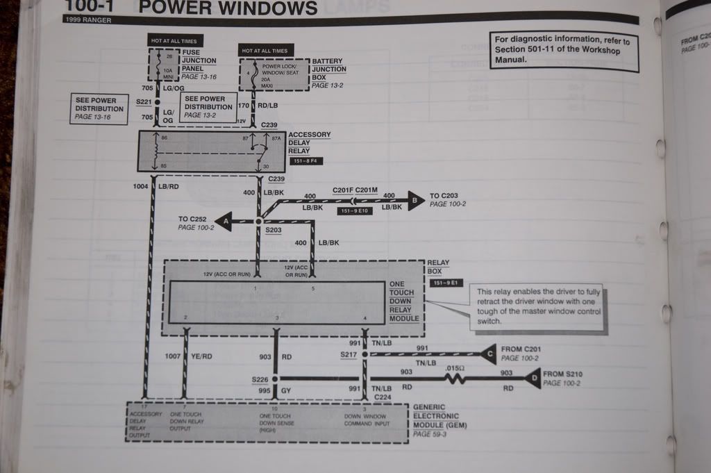

This should help...
^^i found that schematic as well & honestly I havnt had to read one in almost 10 yrs so it doesn't make a lick of sense lol.
