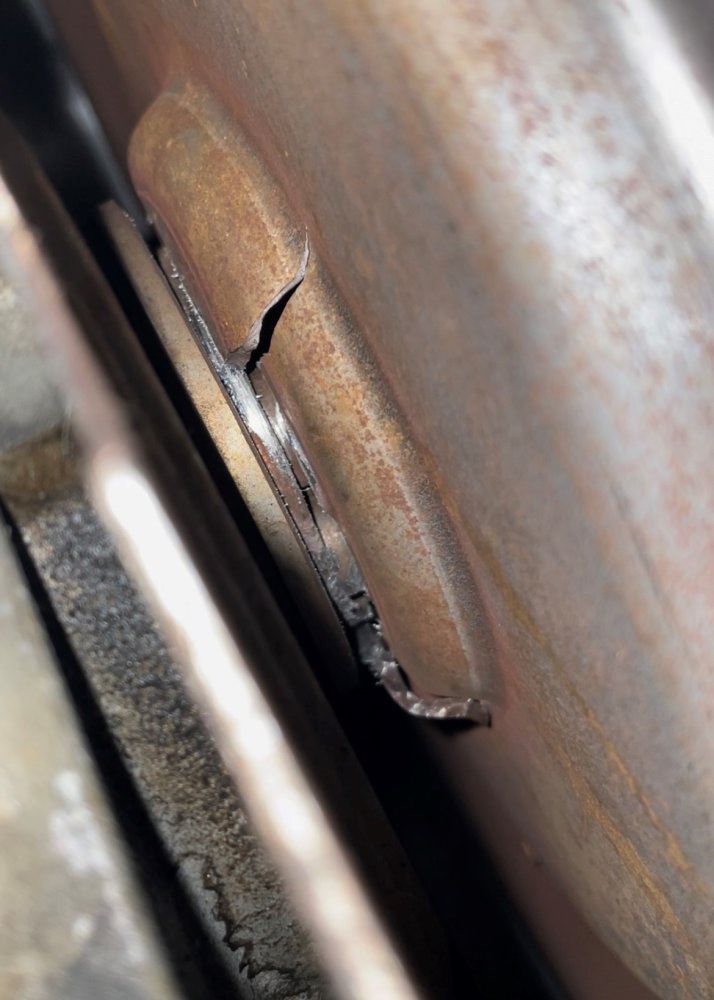

Many months later....
It is definitly the flex plate. I finally got time to pull the starter and look in. The torque converter and tranmission side from what I can see look cleaner than the enginer and flex plate. I guess they probably didnt change the felx plate when the transmission was rebuilt. IDK. No bolts floadting around that I could see.
Next step is replacing it and hoping it stays good. If anyone has replaced one before I'd love advice. I am hoping to just pull the tranny back vs dropping it.
