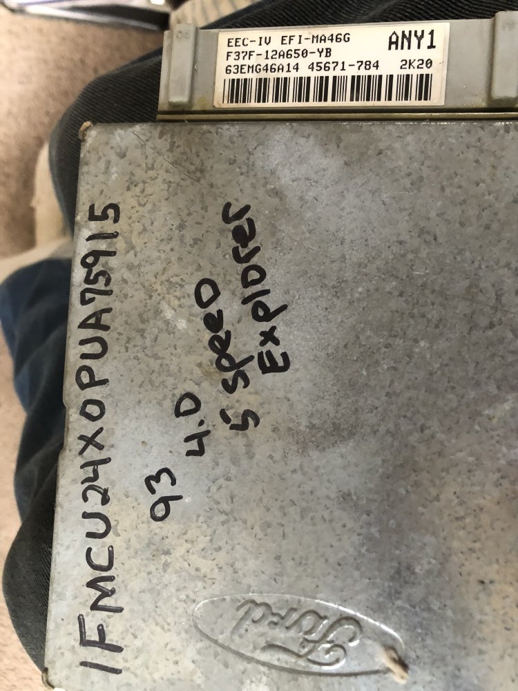

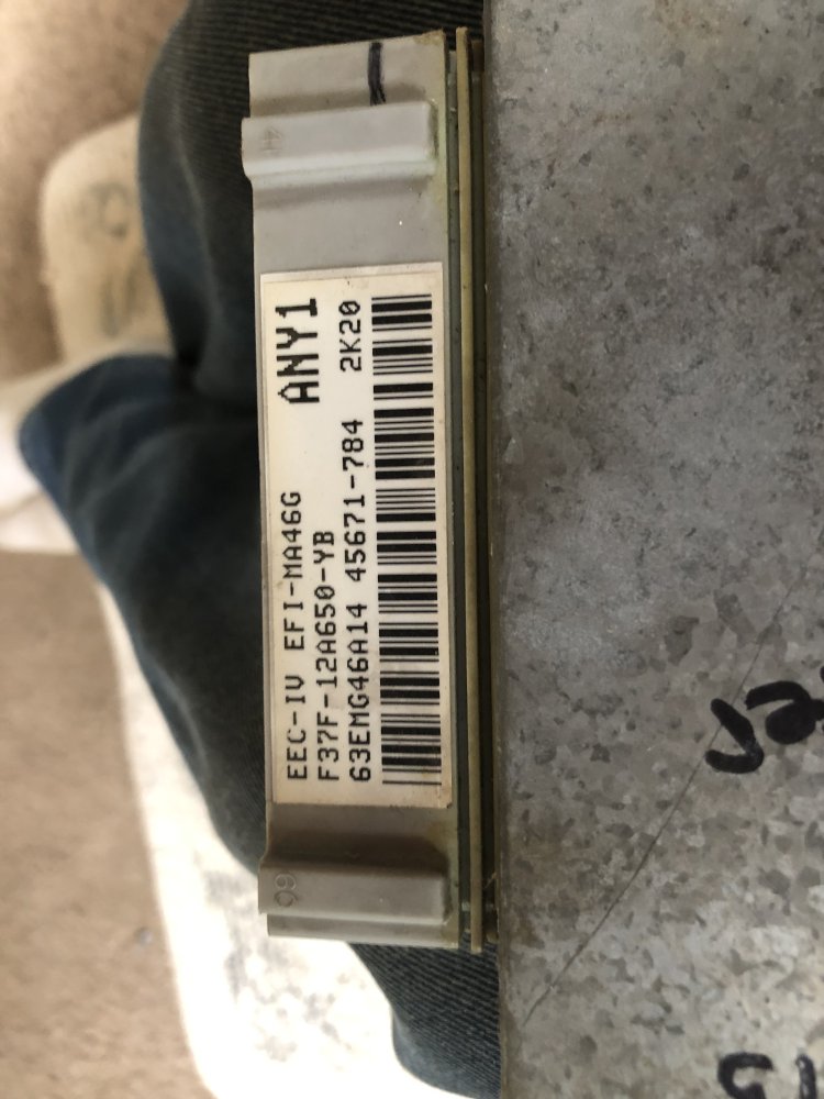

here is a 93 explorer. it was a 4 X 4 but shouldn't make any difference. wouldn't hold water but ran g
I have a 1993 4.0 ranger XL rwd manual transmission with California emissions(so I've been told, not 100% on that part) can anyone tell me what the ford part number is for my original ecu, or at least one that would be comparable to work in my truck? I fried mine and lost it in a pile of about 7 ecu's chasing down the bad ground that caused all my headaches over the summer. Vin is 1FTCR14X0PPB02593
Bought it for the 5 speed setup. Ran great wouldn't hold water. was a 4 X 4 . Shouldn't matter though.
Its a different person, he highjacked this older thread, from 2018
We don't know engine size or transmssion type just 1995 year and name is Confused ford owner, post #4
