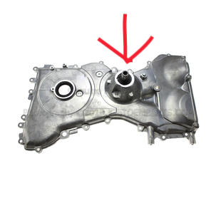

I Replaced the fan clutch and its working great, however, when disassembled, I noticed the bell shaped pulley has some wiggle and I definitely hear a rattle when starting up. So Id like to fix this issue, but I cannot tell exactly what to do and cant find any videos. So my questions are:
1. Do I need to replace the Timing Cover?
2. If yes, that is a big job? Have any tips?
3. If no, How do I remove the pulley?
4. Is this not really a problem?
I have attached some pictures for reference. Thank you in advance.

The pulley can be replaced but the bearing is in the housing itself and is not serviceable. You have to replace the whole cover. Not a fun task...

The pulley is just pressed onto the shaft, you use a basic 3 jaw puller to remove it. Unfortunately unless the pulley itself is bent, the only part that can go bad and cause any noise is the bearing. The bearing is pressed onto the shaft, the shaft is then pressed into the timing cover housing.

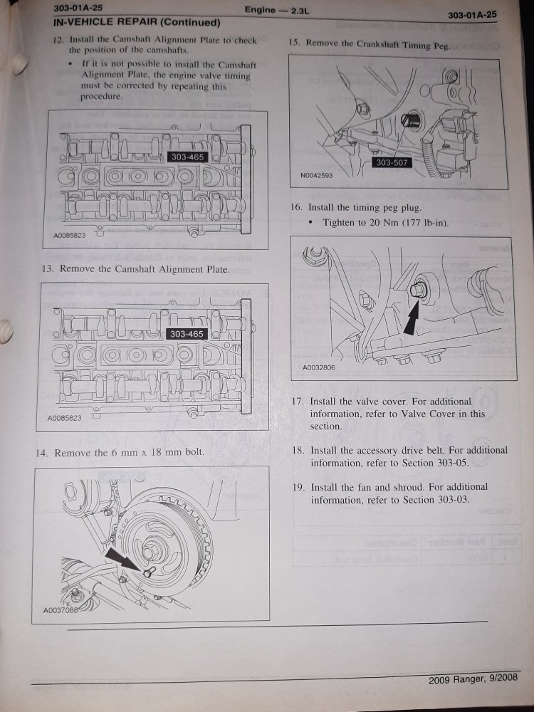

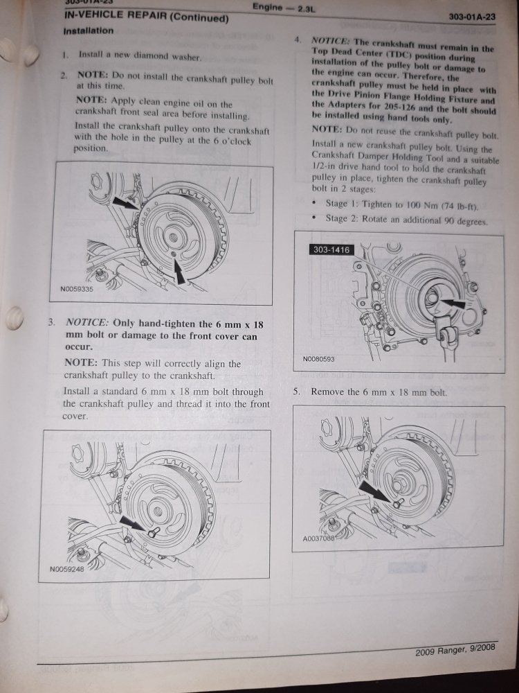

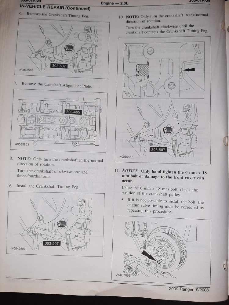

I sent one section on replacing the cover, I thought the PDF I had covered it all but it does not include the very important procedure for locking the cams, I have to actually scan my book for that part. Give me a little bit and I'll try to put it together in one simple file.

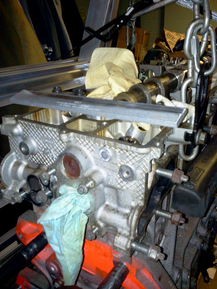

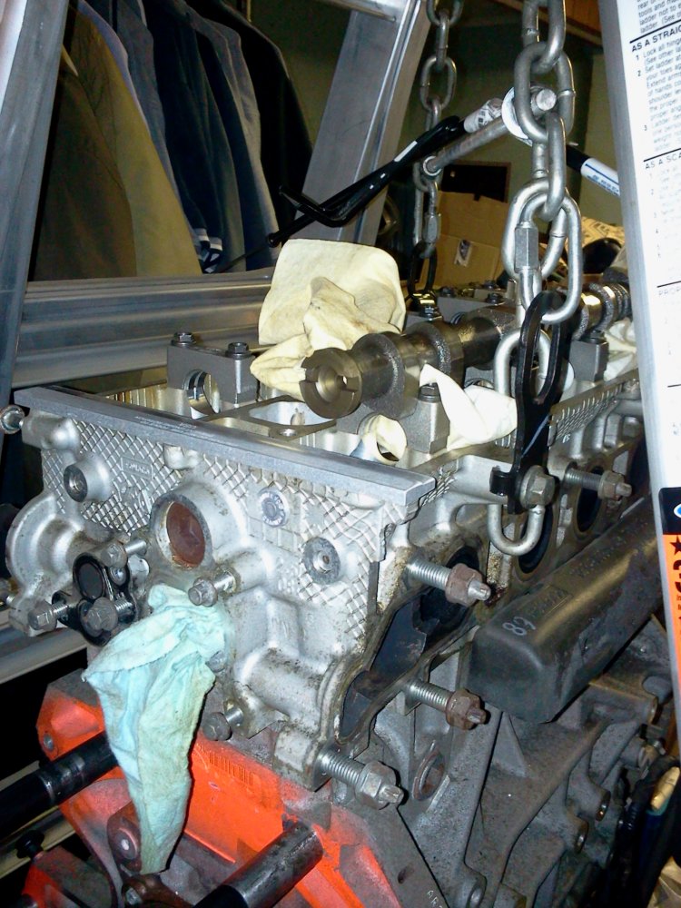

the tool for locking the cams is a machined piece of 5mm flat stock.
it fits into slots in the rear of the camshafts., and touches the head.
it only fits if the cams are in the correct position.
in the pics the cams are removed, the exhaust cam is just laying on top of the cam retaining caps.
47614
47615
Don't forget you also lock the crank in place.

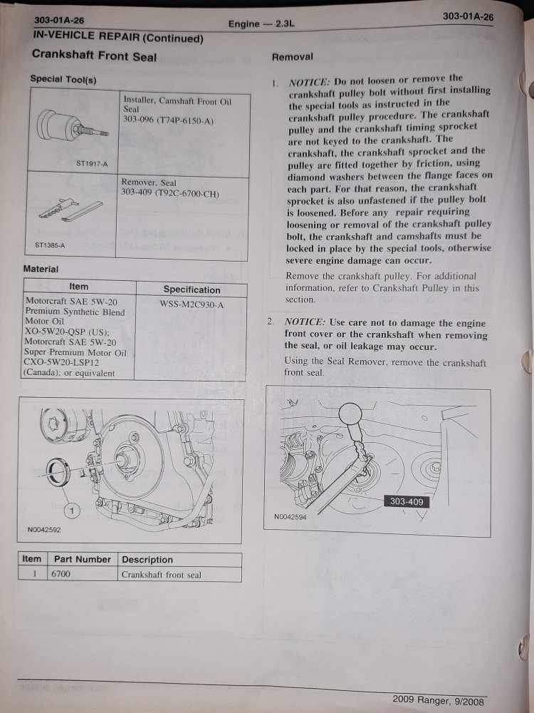

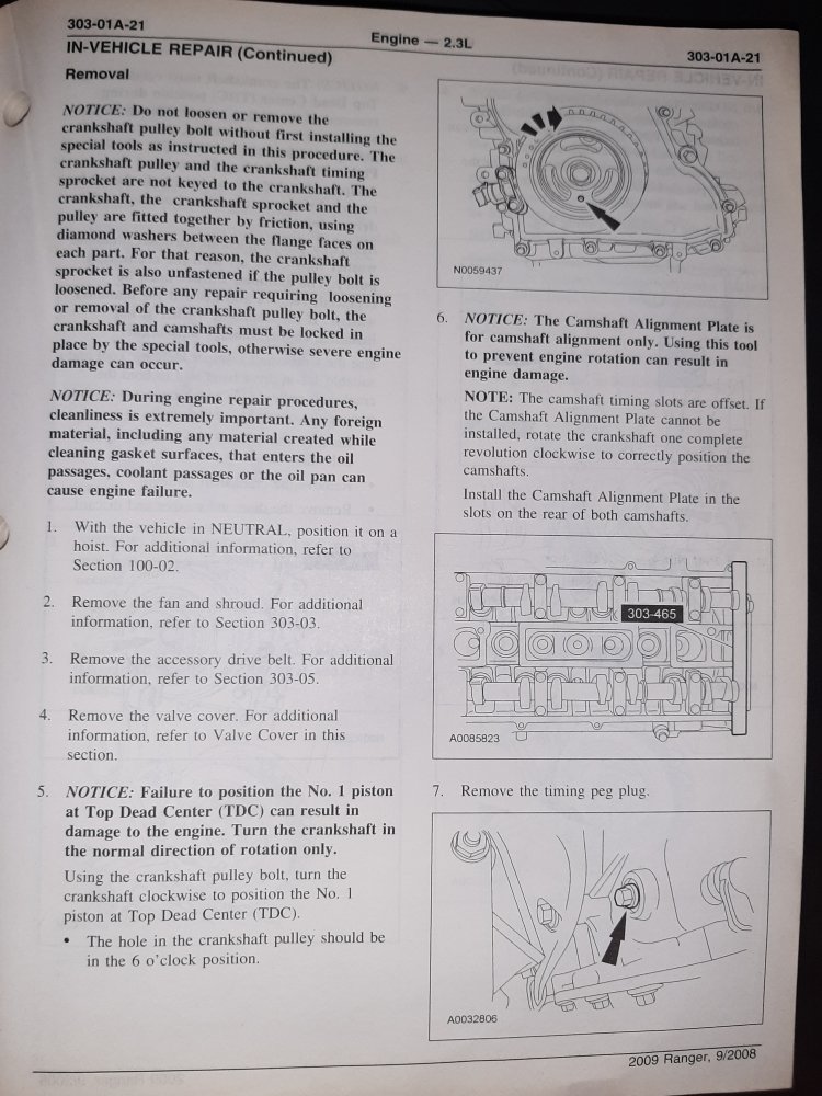

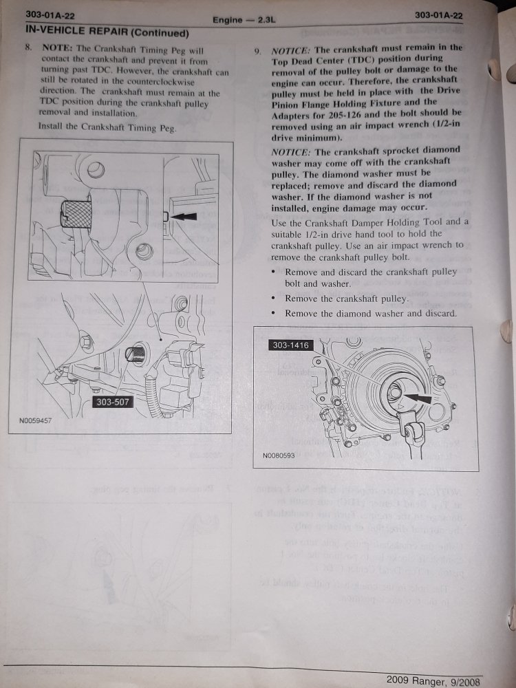

I can't effing figure out how to scan this into PDF so just zoom in on the pics, they should be high enough resolution.
View attachment 47624View attachment 47625View attachment 47626View attachment 47627View attachment 47628View attachment 47629
You are a Godsend!!! Thank you, sorry about the email, I wasnt getting notified that the thread was getting responses. I am working on it now, and I will let you know how it goes. Im thinking of replacing the harmonic balancer too, I should be able to just install a new one yes?
Shouldn't be any reason to replace the balancer. You should replace the diamond washers though. Those stupid things are the only thing that holds the engine together...
