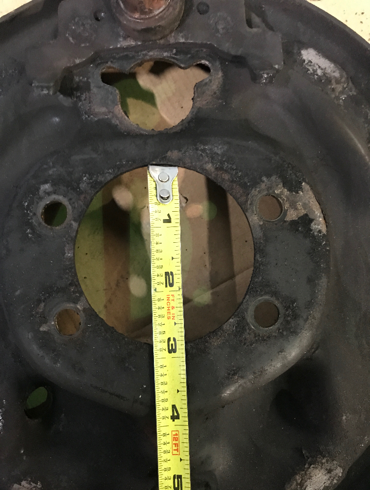

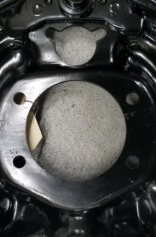

Hey everyone, my truck has been down for two weeks, because of a rear brake job. The backing plates had bent pins, so my mechanic recommended changing them. Neither him, I or several dealers can get the correct parts. They all list the wrong part number. The parts they keep sending have a larger center hole and the 4 bolt holes are spaced too far apart. The part number in their catalog is 2L5Z-2212-EA and 2L5Z-2211-EA

If they are 10 inch brakes... I believe there are two different backing plates. One for a 28 spline axle and one for a 31 spline axle.
Is your truck an FX4?
My truck is an XLT 28-spline 4:10 with limited slip, non-off-road, with BFT package
Manual transmission, long bed, 4x4, 4.0 sohc
Anyone have the correct part number? Why wouldn’t the dealer know this by my vin number???? I gave it to them! Shmucks!
Are they 10 inch brakes?
They also came with 9 inch brakes at some point.
Yes! 10”... that’s probably why this is so difficult. No aftermarket that I know of has the 10” backing plates.
That is exactly why...
They are out there... but they aren't cheap.
I would reconsider replacing them and just clean then up good.

Can I bend the pins back with a hammer or are they going to break? I’d rather just get new ones. I’m already in this thing.
So the anchor pins are bent?
Yes! They look pretty bad! 😆 I don’t know... maybe I can heat them and tap them back, but I’d rather not play that game. Not with brake parts. ...Damn! What a pain! Why wouldn’t the dealers know by my vin number?
