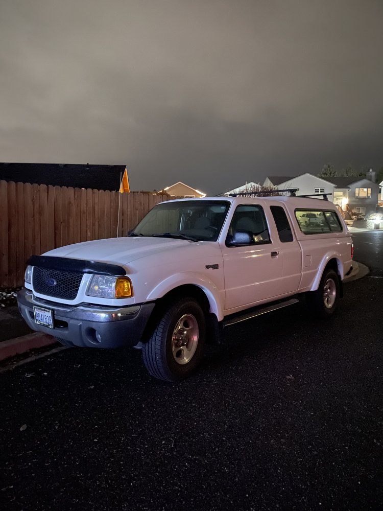

Thanks. I’ll try and post pics as I do stuff. Here is a pic of it now. Also, are there any common quirks I should know about? Also, what does PreHEC mean?

Good lookin Ranger!

As Dill said, nice looking truck. I'm liking the flares. Those are not factory, are they?

Honestly not sure. I’d need to do a bit more research. My grandma asked the same question yesterday when I was showing the truck to them. I’ll try and get back to you.
They appear to me like they're factory flares that have been smoothed&painted.

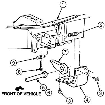

also, what do you think would be the most cost effective way to get a lift? Not looking for more that like 3-4 inches. Just wanna fit 33’s. Not opposed to new shocks but I don’t wanna spend a whole lot as I’m 17 and make like 450 a month lol.
Thanks for the help.
Reading through the above ^^ would be a great place to start. With how your front suspension is set up.. you can get 2-3" of (front) lift for free. Free is just about as cost effective as you can get lol.
That being said... you might find that maxing out the t-bars for lift isn't all its cracked up to be.. why?
Vehicles come from the factory with a relatively balanced amount of up-travel (what needs to happen when hitting a bump) and down-travel (what you want to happen when driving over a pot-hole)..
The more you crank the bars, the less down-travel your going to have.. decreasing ride quality.
Ok, thanks. It already sits pretty level so they might have been cranked already.
