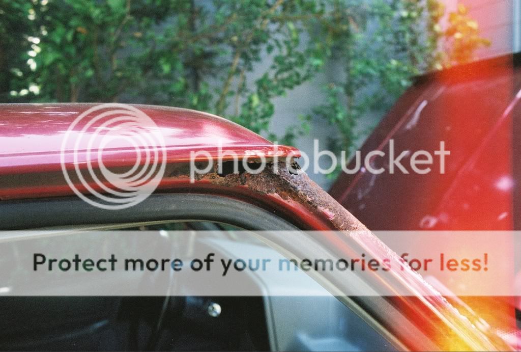

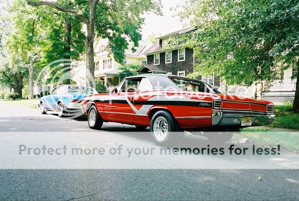

What's going on everybody? I just re-registered after being de-registered back in July due to some weirdness here. I am glad to have a resource again for my truck. I have a 1992 Ford Ranger super cab with a 3.0L V6 and a 5-speed. I bought this truck back in June to replace my gas guzzlin 78 Chevy Malibu. The only work I have done to this truck is some body work on some rotted out areas. Here are some pics of my truck and my other projects.
XLTbeater
Welcome and thats a nice looking malibu and LTD, and the ranger is cool, well cus its a ranger.
My fault!! I should have said that the blue 78 Malibu was mine and the red 67 is a friend's project that we have been maintaining. It does more sitting than anything else. I have another Ford truck that is a 1953 F-250. This is my permanent project and the truck will live again; when I get the money and time for it. The LTD is my mom's daily driver. When I am done working on that car (needs new paint and I will build a 351 EFI engine for it) I will start working to get the Ranger into a more presentable state.

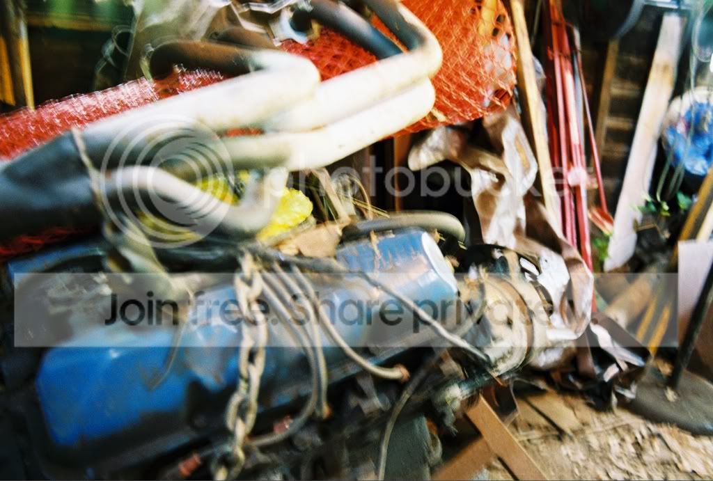

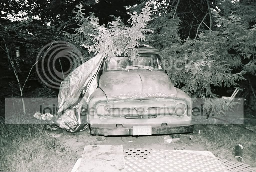

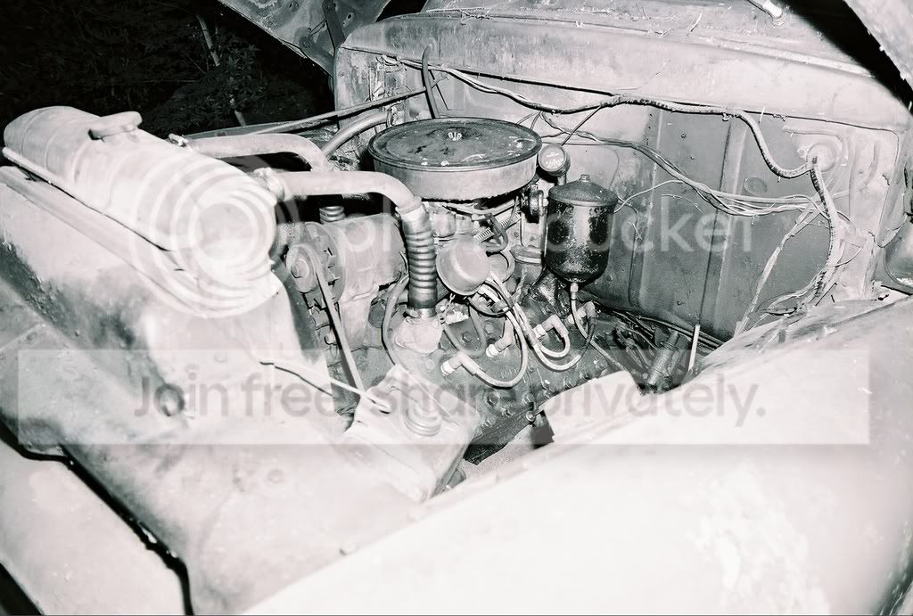

I love old trucks too; which is why I bought that truck from my dad when I was 14 years old. I had plans to resto-rod the truck, but high school and later college were taking too much time and money to attempt such a task. That was a good thing because I was kinda getting into the billet phase back then and I would have wasted money on something that I would not like a few years down the line. Here are a couple of pics of the engines for the 53. The first is the cracked flathead that is in there right now and the other is the 390FE that I will rebuild as the first engine for the 53. Hopefully I will eventually save up the funds to find and rebuild another flathead.

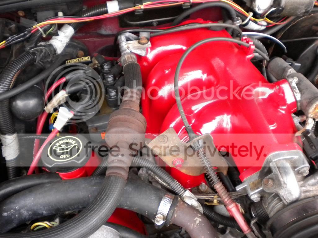

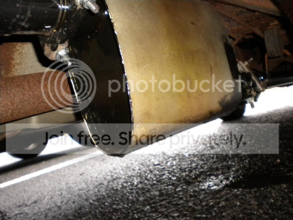

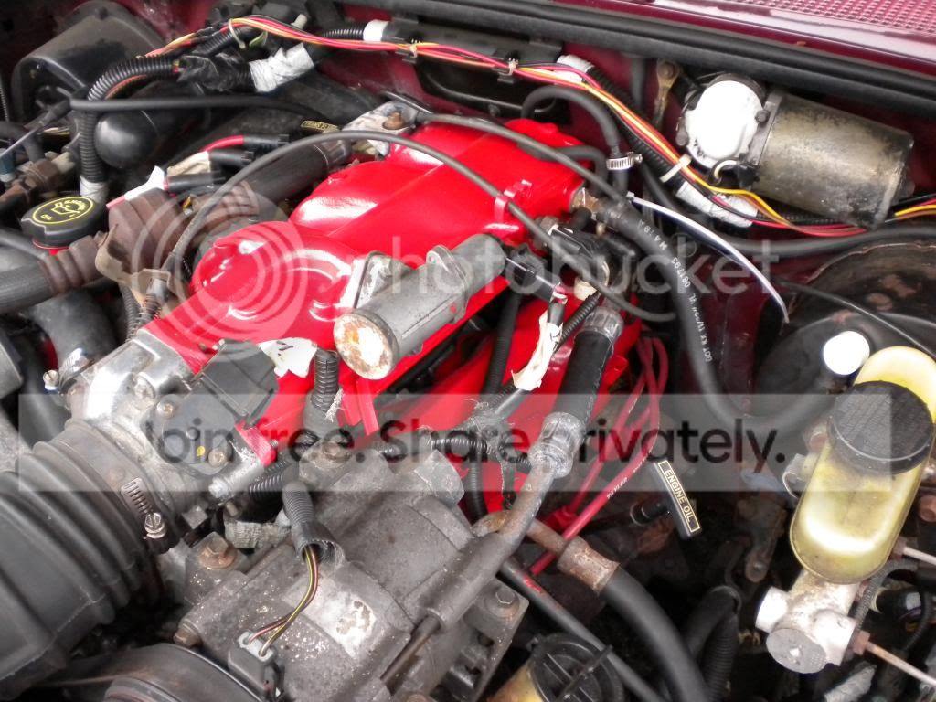

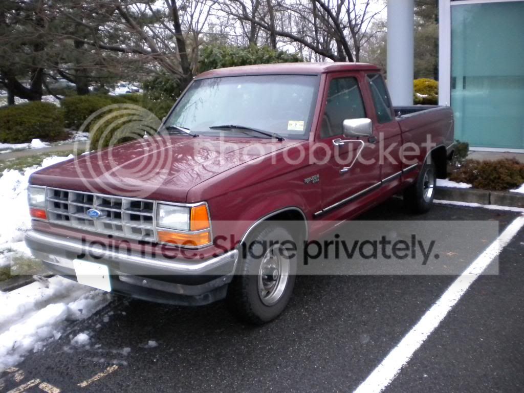

I must apologize; I thought I posted pics of my current Ranger. It's the same as the 1st Ranger except that it's a year older and has options (power windows and locks). The body is in much better shape as well. I just got done replacing the exhaust from the cats back. I installed a Summit turbo muff that was going to go under my mom's car (found a quieter muffler). It wasn't quiet enough, so I scrounged around the garage and found my old resonated Monza tip from the Cavalier. That has made the Ranger almost drone-free. I also replaced the intake and valve cover gaskets; and also painted the valve covers and intake. I replaced the wires as well along with the plugs. I have a DUI coil pack waiting to be installed. I will get fresh plugs for that because I will need to open the gap a bit. So here are the pics. N-JOI

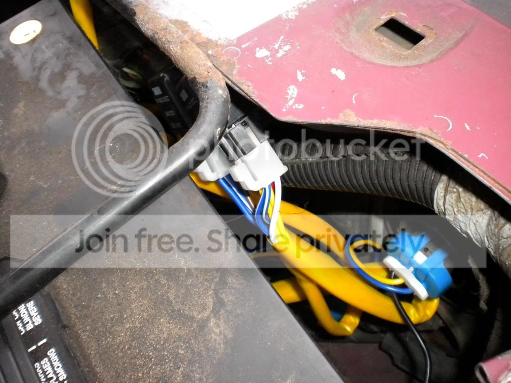

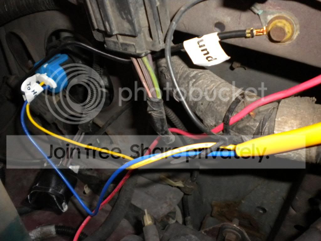

So a couple additions to the Ranger. First is the headlight relay harness upgrade. I did this back in January. I had teh switch in the LTD burn out on me and I thought that while I was at it, I would install the harness in the Ranger too.

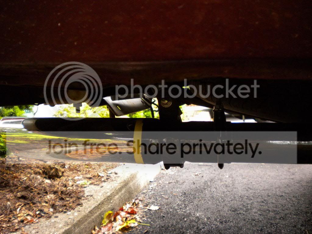

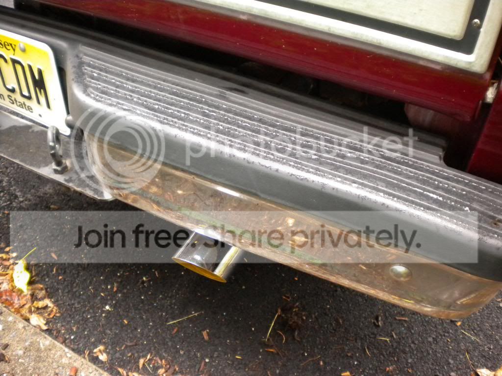

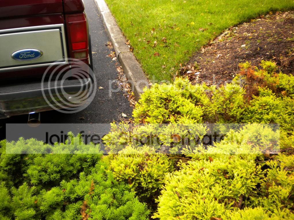

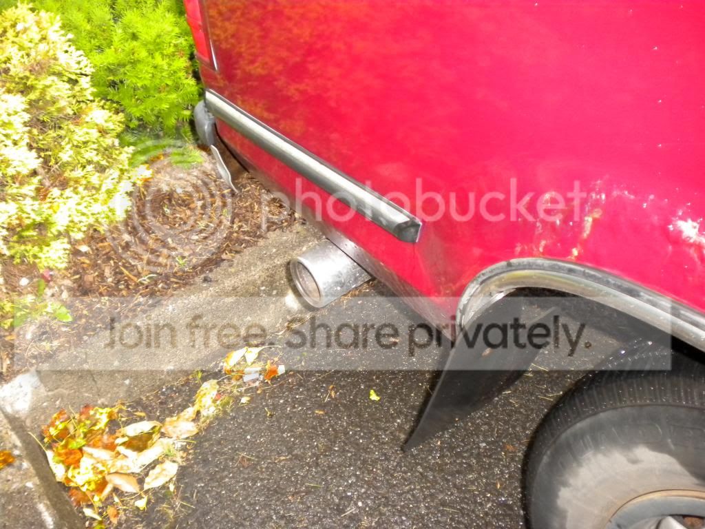

A month ago, my 17 year old exhaust tip fell off. I guess 15 years of getting kicked around the garage floor (that saw a few floods) may have taken its toll. The inner perforated pipe separated from the outter stainless shell. At least there was still a little of the fiber glass packing left. So I got another exhaust tip, hacked off the 90* bend in the tailpipe, and ran it straight back. I used adapters, hangers, and clamps that I had lying in the basement. The truck is quieter now than it was with the old tip intact. Here are some pics.

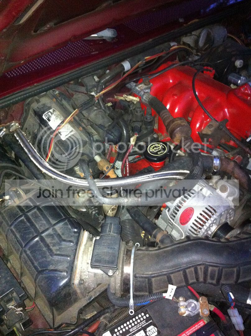

Next up is a 3G upgrade. Luckily for me, the F4TE 351W (LTD project) that came from the '96 F-250, shares the same alternator case (except that it's a 3G); so it was traded in as a core. This is an easy upgrade I did for the Crown Vic, so when I am not being so lazy, I will do this to the Ranger.

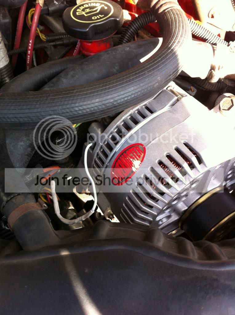

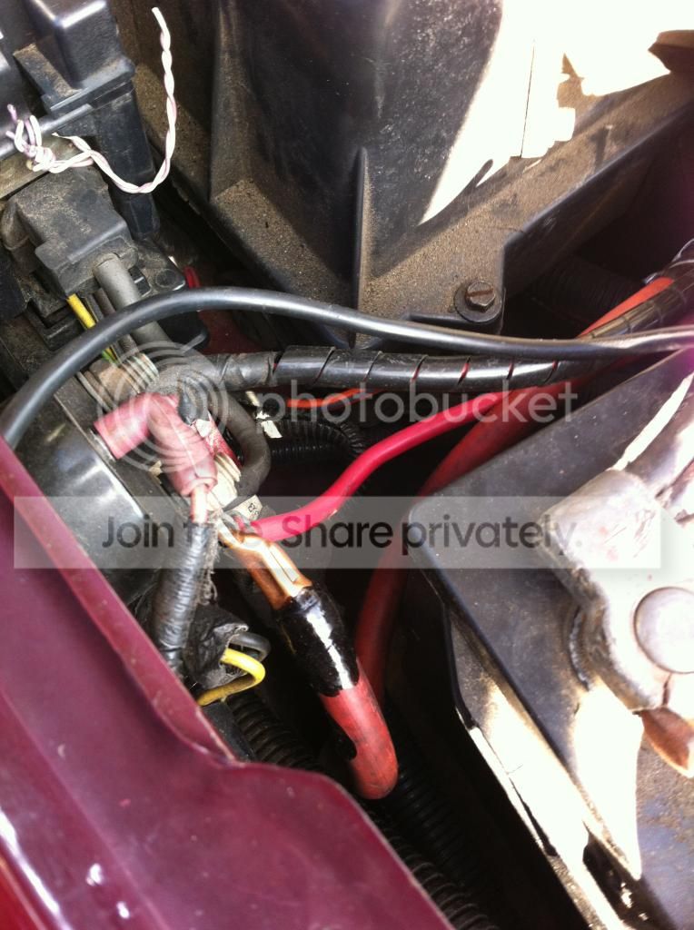

Here are a couple pics of the 3G swap in the Ranger. Since it shares the same alternator casing as the '96 F-250, it just drops right in. Snip off the 2 charging cables (fatter black wires with orange stripe), duct tape them off, and disconnect at the fender relay. Separate the white wire and solder on the pigtail that goes into the single port on the alternator. The regulator harness just plugs in (you do nothing to this harness). I used 2 gauge cable and a 175A Mega Fuse for the charging duties. Route the cable and viola, 3G.

Also, I had to replace the headlight plug on the driver's side on my LMC headlight relay kit. The plugs that come with the kit are flimsy at best. The driver's side headlight was progressively getting dimmer and would shut off when driving. After several months of this, it gave up all together. I cut the LMC plug off and soldered a NAPA plug on yesterday morning. The driver's side headlight is bright as anything. Upon inspection, the ground was charred and bubbled the inside of the plug housing. I didn't have enough time to switch the passenger side plug as that has been dim for a year now. :-/
