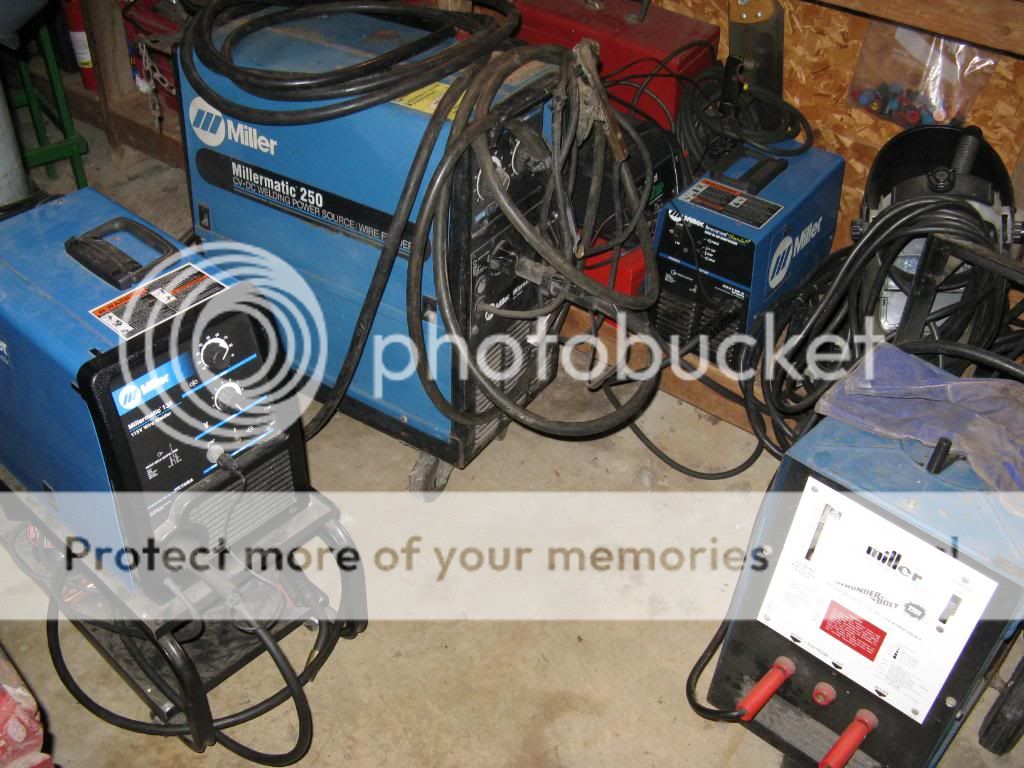

I picked up another welder, a millermatic 250. Worked on that a bit to try and fix what the previous owner couldn't figure out. But that's done. Now I just need a new regulator for it and it's ready to roll.

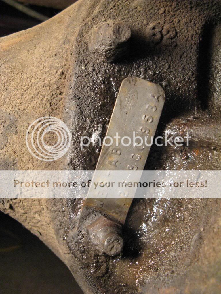

If anyone would like to tell me what axle I have, that would be sweet...
I'm guessing it's 3.25 gears 8"

Yo,
The way I usually tell is if you cannot get a socket and ratchet on the bottom bolt (you have to use a box wrench), then its an 8". If you can, then its a 9".
Yo,
also the 9" should have a depression on the drivers side of the back cover

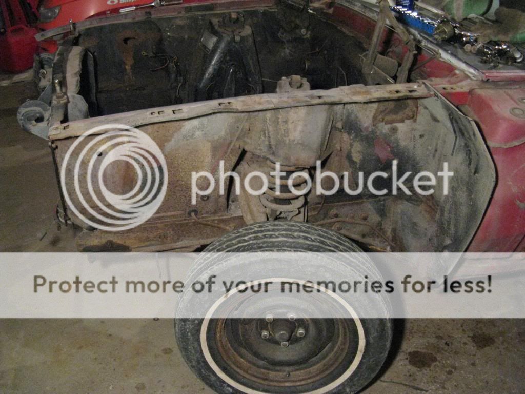

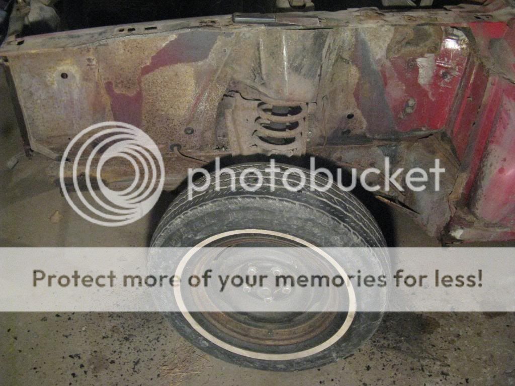

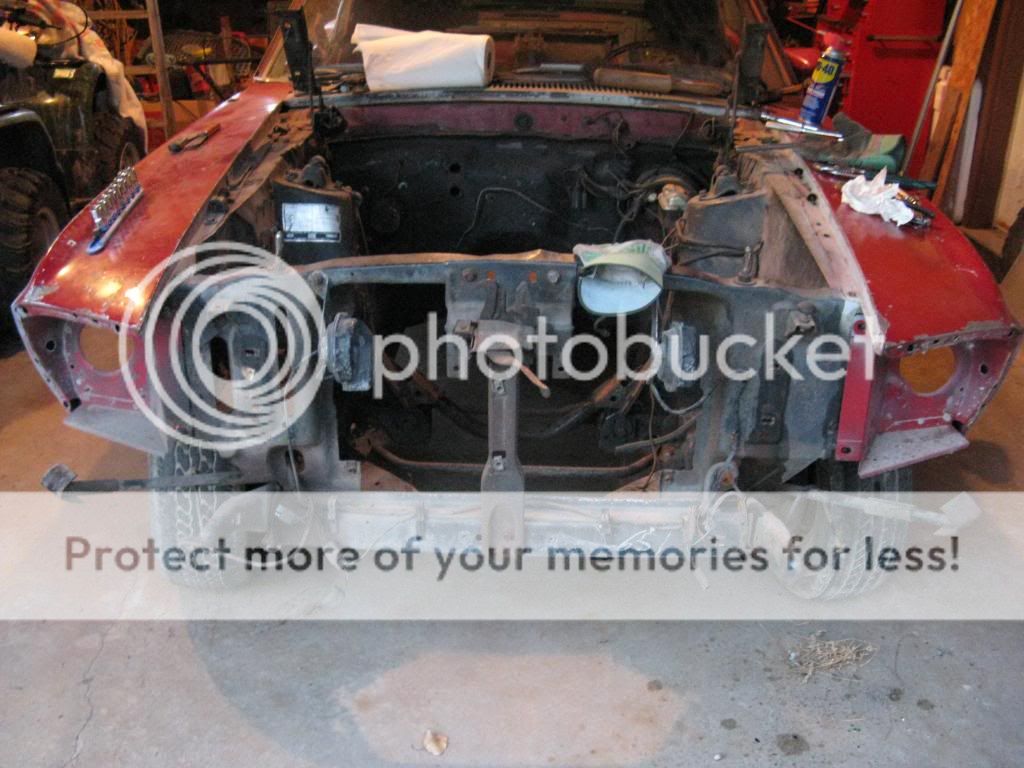

Removed headlight housings, bumper mounts, battery tray, window washer reservoir, inner fender splash guards, and the driver fender. I found out that indeed Ford put the vin number under the fender on a driver side fender apron.

After scraping most of the undercoating off...

If anyone would like to tell me what axle I have, that would be sweet...I'm guessing it's 3.25 gears 8"
Hell Yeah!!!!!
Good guess! It's also "open". If it were a limited-slip diff, it would have an "L" in place of the decimal point = 3L25.
If you plan on any kinda "grunt" under the hood, you might wanna consider upgrading to a 9" diff after you get it running. :dunno:

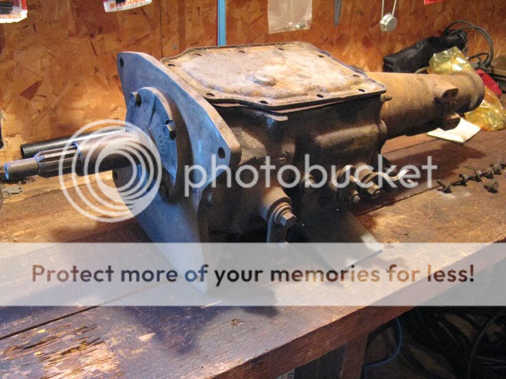

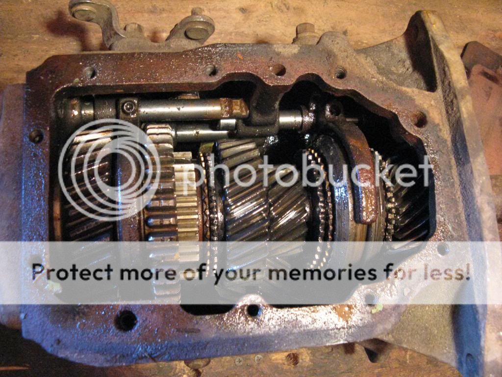

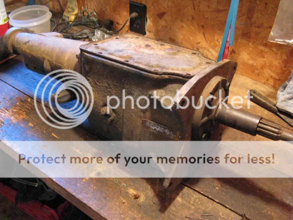

After further inspection, this is not a toploader 4 speed. :bawling:
It's an imposter. I guess in the late 70's they had a look alike overdrive tranny that was almost the same, but not meant for performance.
Glad I didn't pay much for it.
On a positive note, I do have a '79 302 and manual bellhousing for it. It also doesn't need a rebuild, just a good cleaning inside and out.
Duster, I was going to ask what the tag number was on it. Aluminum case? Just classified as a top loader but no strength and the O/D. You want to run a BBF (428 or built 390), try and find one with the 1 3/8" input.
