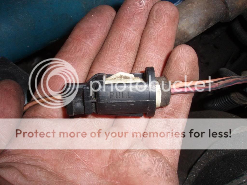

Most of the wiring is done, only need to wire in the fuel pumps (having touble locating the wires right now since my B2 hayne manual doesn't show anything for the B2 fuel pump wiring) and hook up the fuel lines and it will run! I'm really surprised on how easy the wiring is for this swap considering I left my original B2 harness and dash, it was just really intimidating to look at the pile of wires for the engine harness. Also got the M5OD and y-pipe in yesterday.

Fuel pump connector *should* look like this. Should be just under the brake fluid reservoir on the engine side of the frame. I am 80% positive this connector is the 'big power' (or 'switched power) from the relay going to the fuel pump.

Spent the evening running the fuel pump power (it ended up being a wierd round connector Dishtowel), change engine oil/filter, run fuel lines, hook up cooling system and add water...
