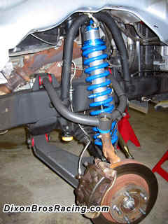

Ok maybe I won't do a D44 TTB that sounds like a lot of work for a daily driver lol. How can I do maybe a mid travel setup. Is that what you were saying with the A Arms? Because the only really long travel kit for a 98-00 4x4 Ranger is the Dixon Bros one which is like $3500. I would like to build parts of it at a time.

haha and dixon bros is a bit overpriced. custom kits are the way to go. i have a couple phone numbers of some fabbers here in california, they might ship the stuff to you but you would have to pay for shipping. your truck is torsion bar isnt it? torsion bars arnt really that good for prerunners (or anything else for that matter) haha. lemmie try and find that LT 4x4 that i mentioned earlier
well this is the dixon bros one haha.

you can have something custom made for cheaper and better. but there isnt much more you can do, you cant put a midtravel kit on a a-arm 4x4 unless you pull out the 4wd and if your gonna do that you might as well long travel it anyways. there isnt really any inbetween cause of the torsorion bars and such.
Ya I have torsion bars :annoyed: I wanna just get rid of all of it lol. That kit doesn't look that complicated, especially for how much they want.
