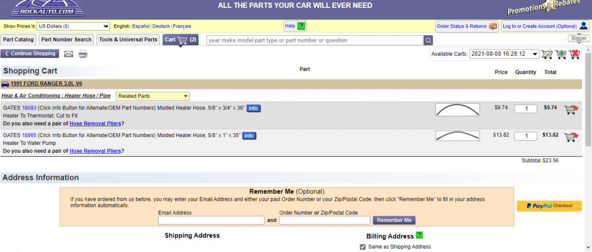

SORRY to revive a 13-year-old thread, BUT... ah made a MAJOR $$ error in the klugey heater hose prices... must've been thinking of the RADIATOR hoses, 'cuz I just found Ye Olde 2008 receipts and those molded HEATER hoses were a whopping $32.99 EACH, or $66 (tax-free) in get-real terms...
This time 'round, got Continental brand instead of Gates, strangely, only $26.79 for the more curvy heater-core to WP (#62848), and $28.79 for the simpler engine-block to heater-core (#62847) from Rock Auto... so much for inflation.

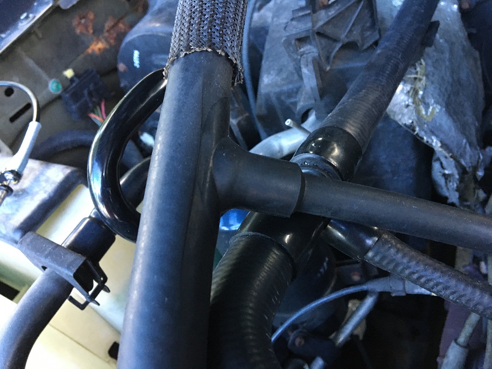

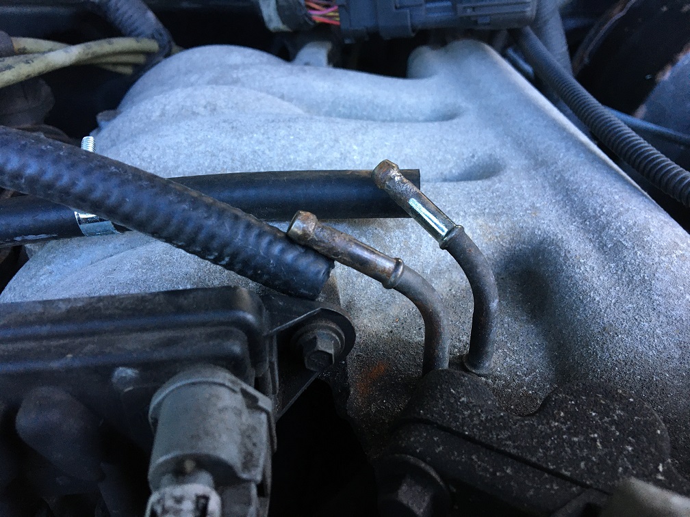

BUGGER all!... "side feeds" on the new Continental hoses even shorter (IIRC) than the 2008 Gates versions! Bloody hell, are you telling me that between molding the large 5/8 hose, and "welding" in that fancy Tee, that the place to save money is cutting the piddly 1/4" side hoses 1-2" short?... REALLY!?...
Duh Guilty Party (notice even the hose diameter and texture differs 'tween the 2 sides... ??)
64020

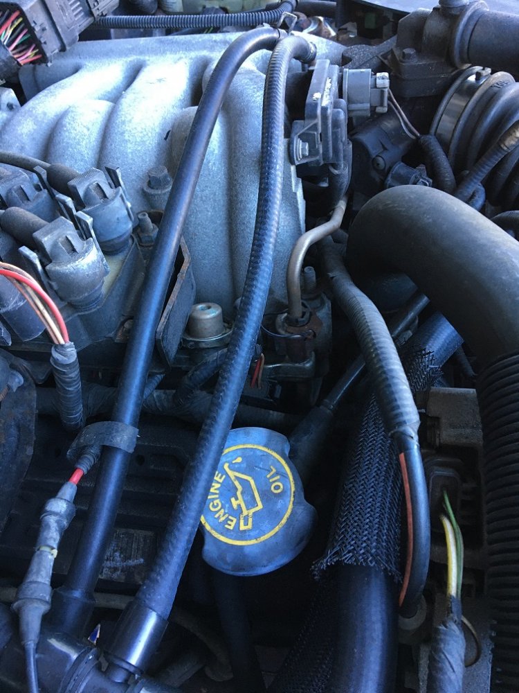

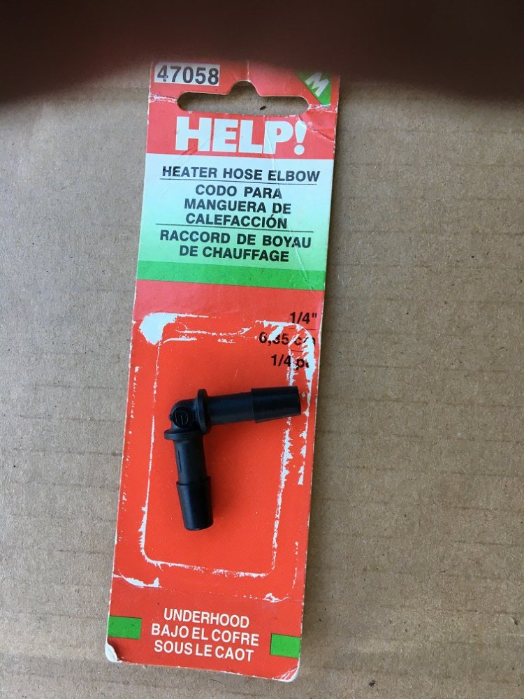

... anyway, had a 1/4" ell I bought in 2008 "for just such an occasion"... short circuit, no more heated (cooled?) intake manifold. Unicoil hose bends looking better all the time.
64021

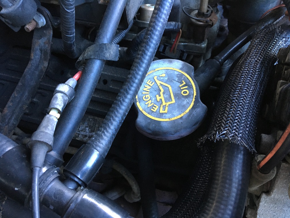

OK, going forward, going to run "cool intake", but for now, whilst running FLUSH load, I stretched them a bit to flush out the manifold...
64590

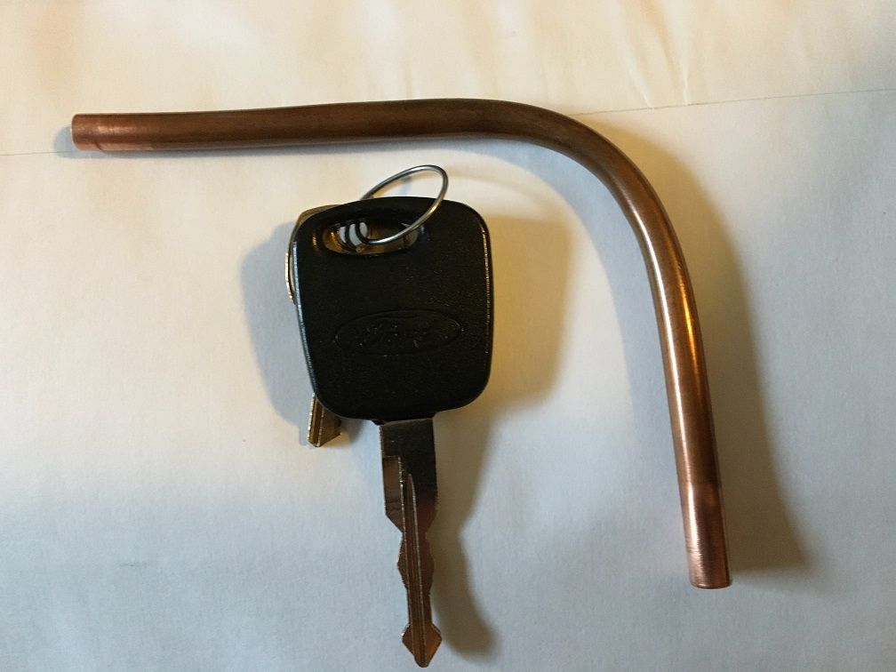

... bit of a hassle to add oil. Since the tiny 1/4" plastic ell I was using was actually weeping a bit, will be upgrading to this copper jury-rig, and since there's no "barbs", I'll just put TWO hose clamps on those long legs:
64592
