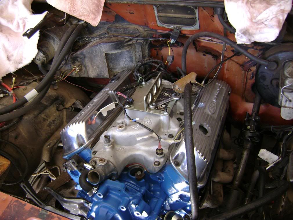

Having trouble getting the valve covers to clear the heater box. This is a 91 Ranger XLT , originally a 4 cylinder but trying to convert to 302. Used 94 Mustang mounts.
Thanks,
Ray
You need to cut a small section out of the corner of the plenum.
I have a 2" BL on my 84 and still had too. I just turned the cut out piece upside down and siliconed it in there. Mine been like this since 2000 or so....
