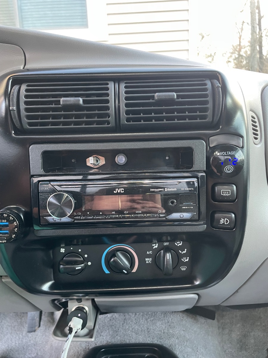

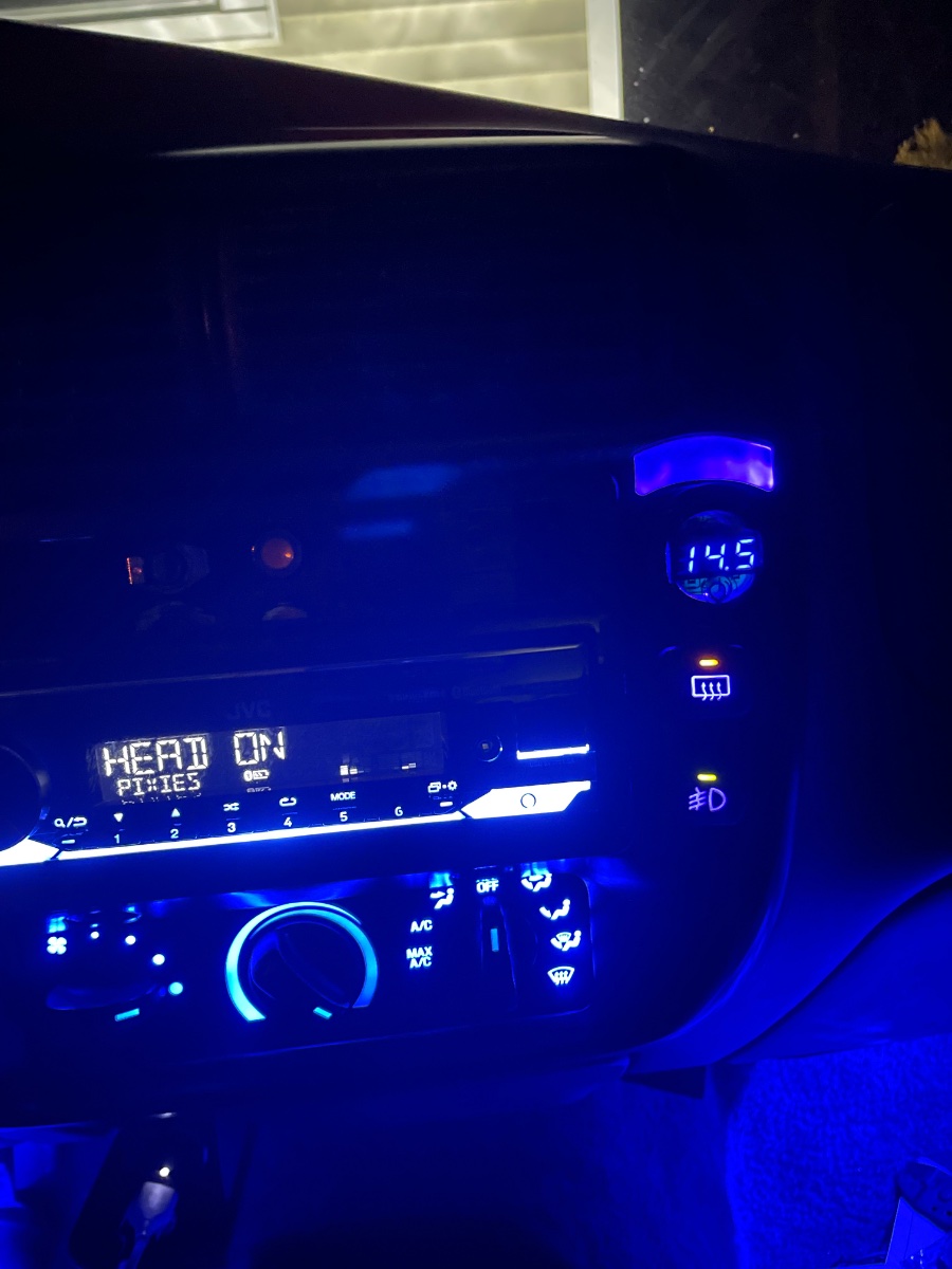

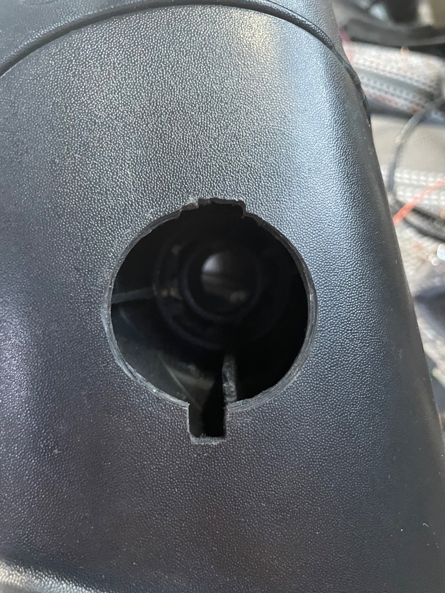

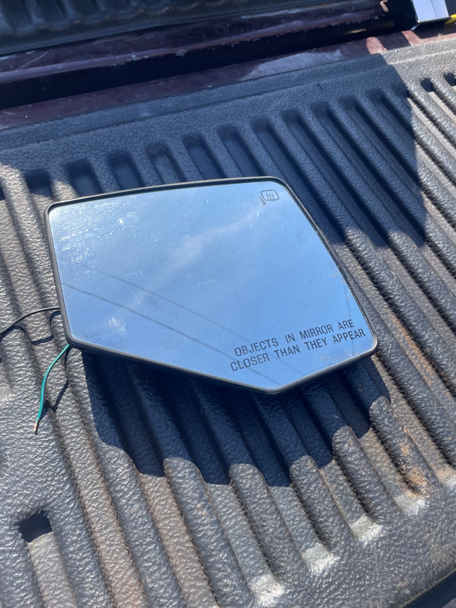

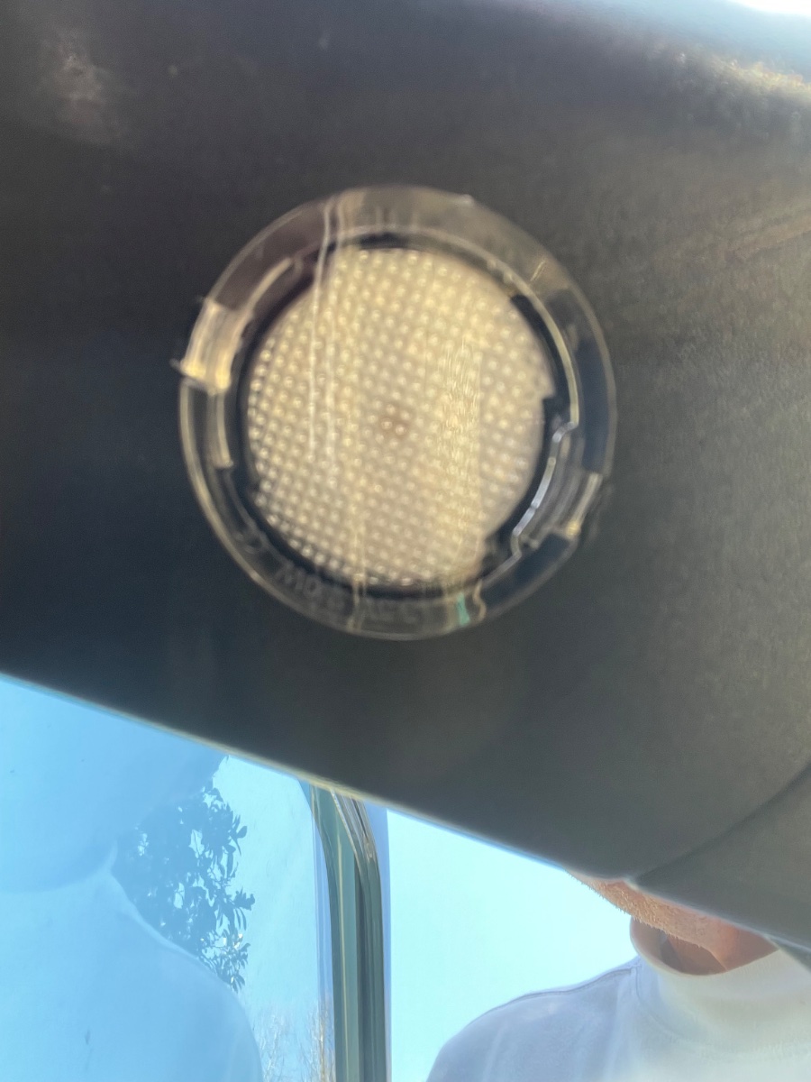

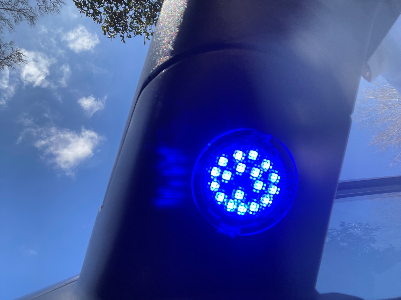

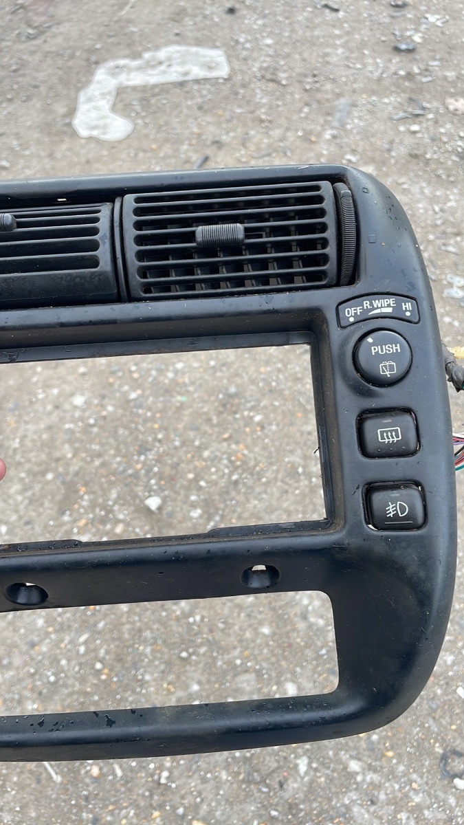

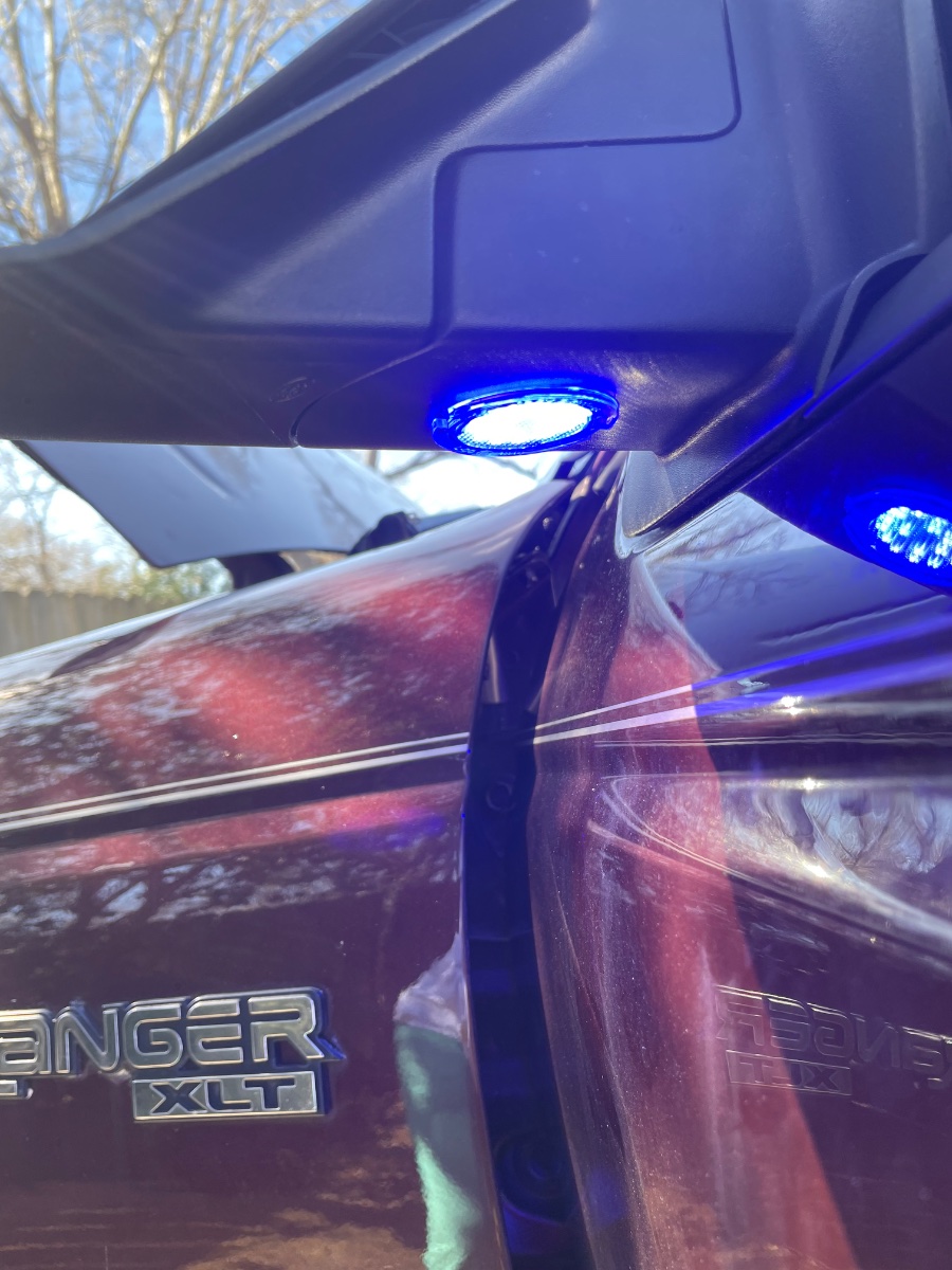

Thanks for help from @mhoward , I now have heated mirrors and puddle lights on my ‘96 with 2006 mirrors. Bezel from a ‘97 Explorer so I could use the defroster switch. Puddle lights from Late 2000-early 2010s Ford/Lincolns. Wired heated mirrors through GEM and a relay, following factory diagrams. Wired the puddles to come on when door unlocked, opened, when headlights are on and blink with turn indicators.
