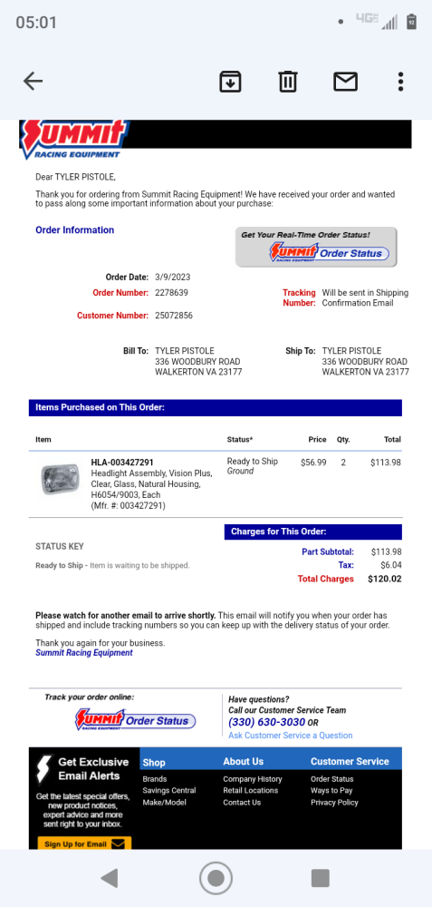

And I went with these. Thanks for the suggestion Gump!
