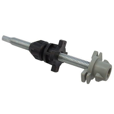

Looking for the headlight adjuster fitting that interfaces with the radiator support. Looks like my truck took a low impact hit to the passenger side headlight assembly.
I'm in search of the dark grey (black) fitting on the left. The four 'stops' are broken off two of the three adjusters. I did a search and saw someone mentioned Dorman & AZ but my local AZ store has nothing. I trip to the local junkyards is going to be more in gas than the price for the entire adjuster units (~$12 x 2) from Ford.
Is there an alternate source for these, perhaps?
TIA.
Shop around. They are sold lots of places, even Amazon, but shipping adds cost.
1L5Z-13032-DA is available online at htpps://www.parts.ford.com
Replace both the left and right-side adjusting screws. The plastic degrades with age.
Ford Part 1L5Z-13032-DA
You should be able to find them with ease at a junkyard.
