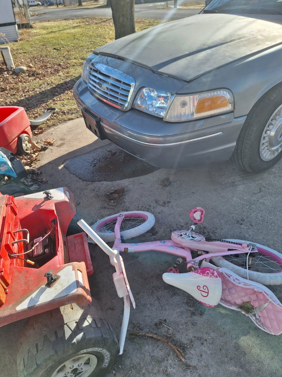

Then my buddy sent me this picture...
Hate to ask again....crown vic help needed once again....
Evidently it decided to leak all the PS fluid out of what he believes to be the pump. So while the damn thing has sat, not running, for a week, it magically decides to do this.
I mean your leak is WAY worse than mine, the fluid on my '97 is just gross and burnt and my '90 leaks out of the pressure hose at the pump... compared to the oil leaks it used to have this is nothing lol
This went all at once...which...ive never seen. But whatever...maybe the pumps been iffy, i know i had to swerve for a deer once and in the process of switching back it cut out for a second. Not even my RBVs do that.
