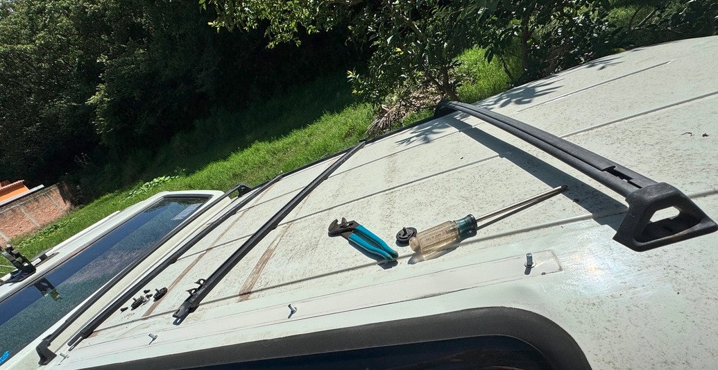

Looks like my new-to-me B2 has a small leak...appears to be coming from one of the roof-rack fasteners.
The OEM rack is secured via phillips-screws along each base/track.
I tried loosening one, but it's going to need additional persuading and/or penetrating oil.
Has anyone ever removed theirs?
Also, is there a universal weather-stripping or sealant anyone recommends?
Thanks in advance :)
I removed the factory roof rack on my 95 Explorer. All I did was unbolt it, throw it away, and siliconed the factory screws back into the holes. (Permatex clear silicone) I never had any kind of water leaking issues.
If there is a leak at the screw, then its going to be rust-welded to the roof skin. It will take a lot of force to break it free. Many times I've used a hammer and given the screwdriver a couple sharp raps while turning. That mostly works. Other wise there is a hand held impact driver that you again use a hammer to turn the screw. Failing those option I would remove as many screws as possible, then drill the heads off.

Was able to get all of then screws loose with a impact driver.
Cleaned and applied 3m waterproof tape across both rails.
Utilized some studs to insure rack alignment before seating rails to the roof.
Has anyone removed the OEM roof-rack on their B2/Explorer?
Finally some silicon rtv on each of the screw heads.
Was much easier then I imagined.
