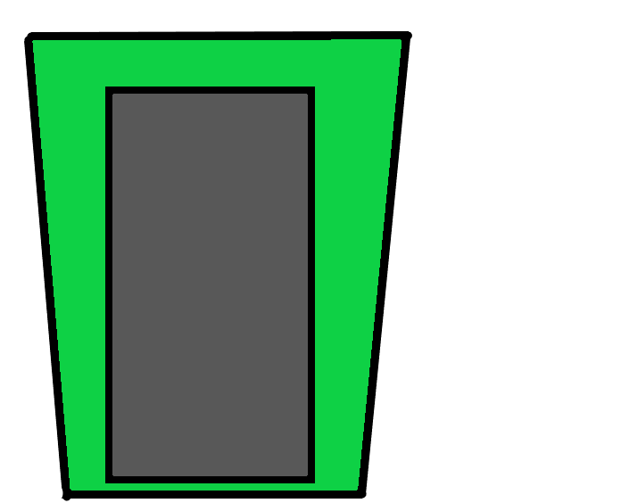

The only thing that may be an issue is the newer, old model Ranger bed sides taper from wider at the front to narrow at the real. The cover may or may not follow that taper. Just something to look for before you finalize the deal.

I’ve never noticed that, how much would you say?

I never measured. Maybe 6” wider at the front compared to the back. This is the outer side walls only. The bed interior is completely straight.
Looks something like this ^^^
