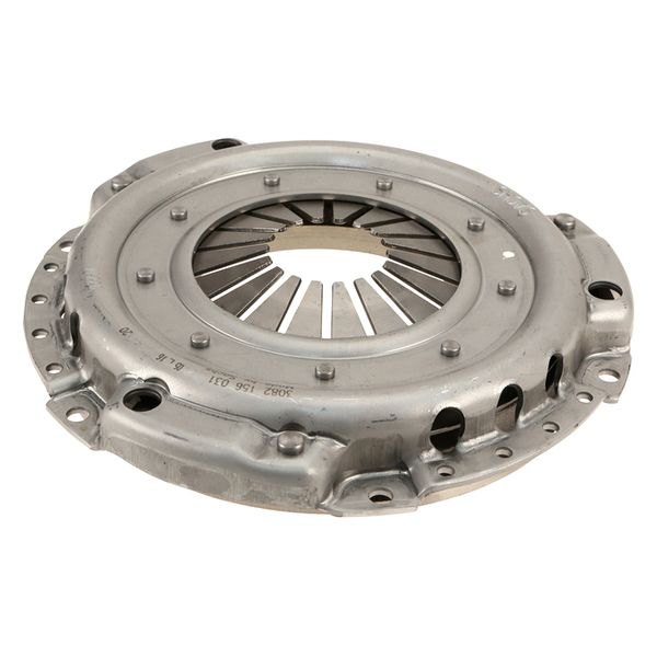

You didn't mention replacing pressure plate, just "clutch" if you reused the pressure plate that could be the problem
A SAC pressure plate MUST BE RESET before it can be used again with a new clutch disc
SAC pressure plate always has these 3 springs on it: https://cdn.nexternal.com/uuc/images/CLUTCH_LUK_SAC.jpg
Can have 4 springs
Regular pressure plate does not: https://ic.carid.com/wp/sachs/w01332624213sac_1.jpg
You CAN use either, but the SAC works best, IMO
