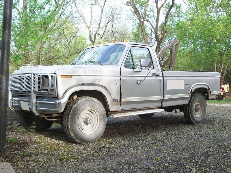

i made mine. i will try to make a picture.
the new style like that one has the rotating jack so you can put it where you need it....
it all unpins easily so you can move it and assemble in nice low weight sections. i dont have an L-5 disk anymore and 1-4 are leaking and slipped so its usually done that way.
i weld on a pully and use a boat winch critter like the higher dollar unit. on the uppper section of the one that got stolen i had a nice winch under slung and the pulley hung from the hook so it was fairly versatile.
with the winch you can open the jack and extend it to max height slowly with your hand and shut it in.... and then moving stuff is very quick. i hate trying to jack it to the full height...its as slow as the engine crane.

Dad's old F-350 had a hoist in the back, it worked great. It could be pinned straight ahead or swivel 360* The top part could be lifted out of the base for gooseneck work. I think it was factory made for trucks, whoever made it it was pretty slick.
He has another truck with a different style hoist (with an electric winch) and the truck that replaced the ol' one ton has a lift gate which IMO gets used a lot more than the hoist did but the hoist was also a helping hand holding heavy stuff while being repaired too.

two strips of angle bridge under the floor that span frame rail to rail with a series of bolts.... its pretty good for 1000 pounds or so and cheap.. its nice for powerwashing engines and transmissions and stuff in the winter at the coin op so you dont have to winterize your crap at home after you drag it out...anf you dont load your rig up with goo and ice...

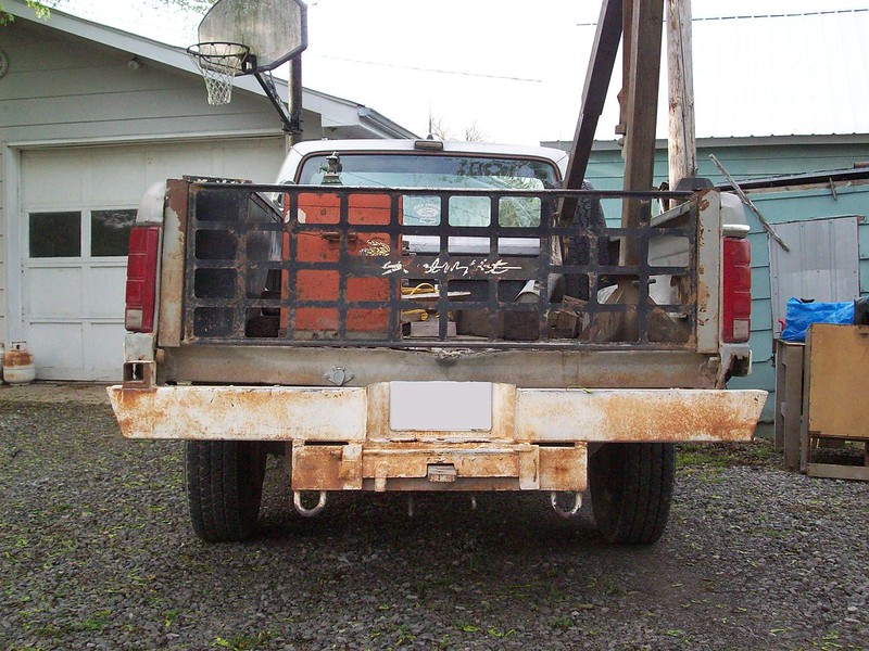

what i am saying is to run two 3-4 foot long 1x2 angle irons under the bed bridging the frame and directly tied to the bottom of the stock bed floor. that makes for serious overkill. 1 inch plate steel would be ridiculous...the total weight offset bias would be uncomfortable.
1/4 in or even 10 g would be fine for a better base.
no matter what.
you have to shim the gaps with washers to the base of any normal bed floor being convoluted.
if you dont shim the gaps...then of course you will distort the floor.
i am trying to make some pics....
you may have to fold or cut sections of the pinchweld ect under the bed.
i dont have one in a normal bed to take a picture...not that i worry about tearing the bed up anyway.
well its not just me...even the kid i had put the pics in my pc said its a pia with my phone setup.
not sure if this will work or not.

Thanks so much for all of that bobbywalter (I'm wondering if you prefer Bobby). I was thinking about 1' square steel sheet either .25 or .375 thick. 1" thick would be a bit much indeed. Great pics. Really appreciate that.
