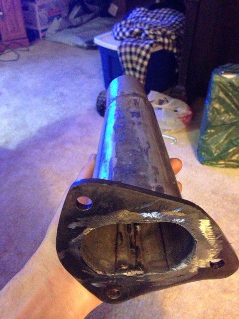

ImageUploadedByTapatalk1426223261.596125.jpg so I got rid of my cats on my truck so I could put a high flow cat on it. Made this so that it was the oval part at the end of the y-pipe to 2.5" round exhaust piece. Might actually make some for anyone wanting to replace their cats with a higher flowing one.

Excellent idea. I've been meaning to do this myself and haven't made the time to do it yet. As far from the motor as this is I don't think it would have any negative effects from decreasing back pressure.
No back pressure on 4-stroke engines, back pressure bad, no pressure OK, negative pressure good

Yupp tried this on my ranger and it works very well. Finished the rest of the exhaust with 2 MAC mufflers with 2.5" piping. Sounds great, and works great. Still got torque all the way to 4000rpm. Need to add some tailpipes and then I won't get drone on the hwy. I'd say 9/10.
View attachment 17935 so I got rid of my cats on my truck so I could put a high flow cat on it. Made this so that it was the oval part at the end of the y-pipe to 2.5" round exhaust piece. Might actually make some for anyone wanting to replace their cats with a higher flowing one.
Hey gotta revive this old thread. I’ve recently inherited a truck that turned out to have the cat cut off. I do the have the remaining piping and muffler, just not the cat. The part you’ve created looks exactly like something I would need to replace the missing cat. Can you provide some more details on making of this marvel of yours? Thank
