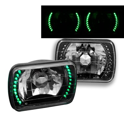

Had a similar set in my 84 Ranger. Had to grind the headlight ring openings to get the rings to go over and screw down. Great light output. Mine were these with amber led's. Got them off ebay also. Now they are just sitting on the truck doing nothing. Truck is going to get scrapped. They should just bolt right in.

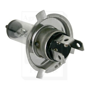

Those lights are setup to use a H4 bulb. Exact same plug as the old sealbeam. The ebay auction also says H4 halfway down in the product description.
Hi,
thanks... i was starting to do some research on these style lights and was getting the gist of how they would be installed. stumbled into the idea that i didn't need a special holder to hold these bulbs.
so thanks for the confirmation on these bulbs :) i get it now.
