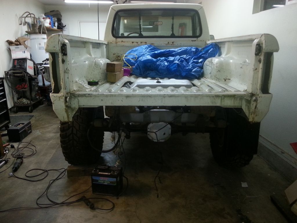

Ok I got my tank mounted. I used a '84 Bronco 2 tank. It is a carbed tank so it will have just a single pickup and no return. I mounted it behind the rear axle where it would go in a b2.
I made a crossmember.for the front out of some square tube I had laying around. I bolted it to the frame where the front of the tank will sit. I then drilled 2 hole holes and welded 2 long bolts through the holes. I fit the tank again and welded a piece of angle iron on the back of the crossmember so the lip of the tank hits it and holds it down
I had to rebend the tank straps (I got them from a b2) and move the strap mounts on my frame.

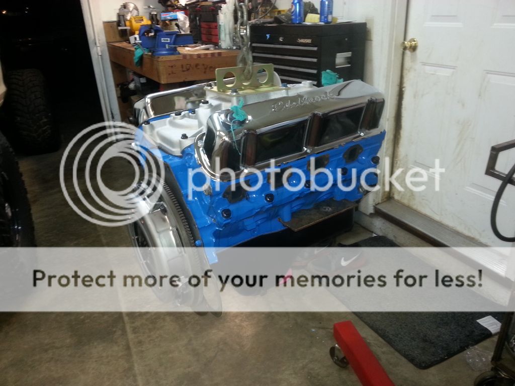

Anyway, I'm using a 302 now. The 351w I had was in bad shape and needed a rebuild

That's a Purdy motor! I've got a lead on another 351 that I'm going to build while I enjoy the rather tired one I put in. Your rig is looking good! Keep up the good work.
I'd love to have a built 351w! I now have 3 302 blocks and a 351w lol
If I built a 351w I'd stroke it to a 408. But building an engine wasn't in the cards for me right now. I needed something that ran good.

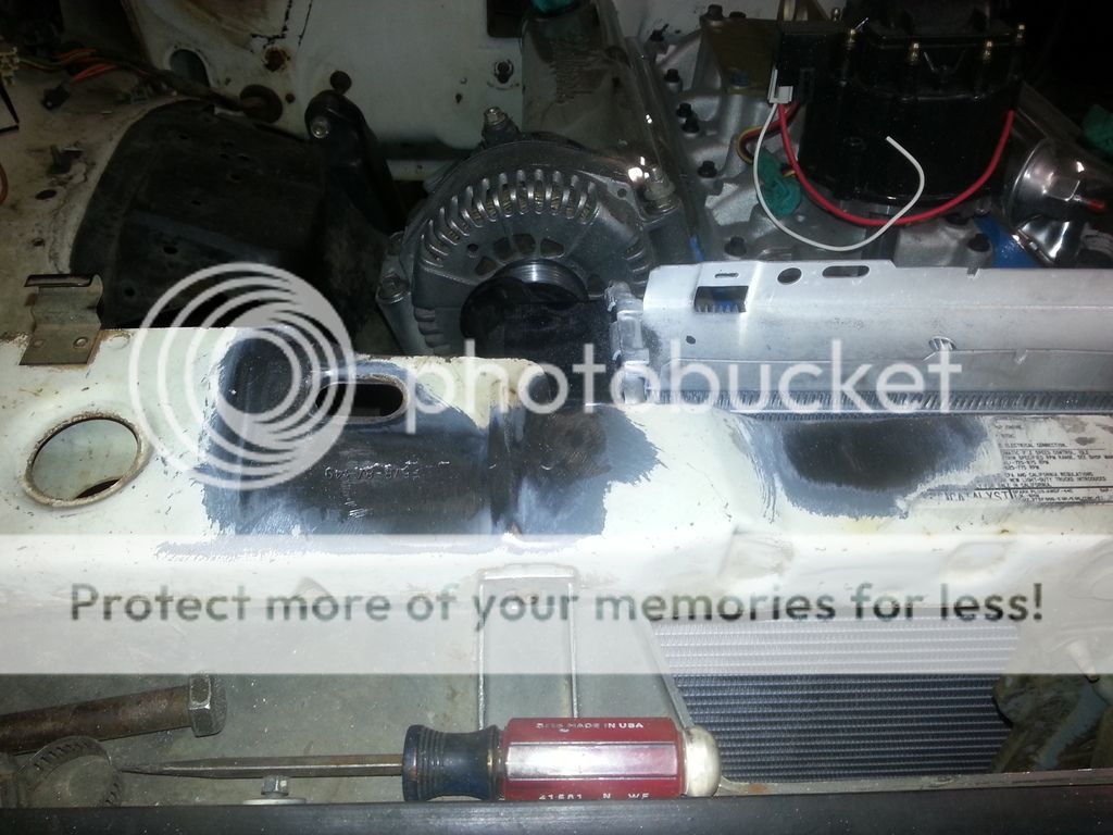

I had to move my radiator into the core support because the upper radiator hose pointed into the alternator pulley. It had about 3/4" clearance. It wasn't going to work.
I cut out this much. I rewelded the captive nuts and plates back to the core support so the radiator would mount to the core support like how the factory did.

Rewelded the pieces back for a better look

Radiator tucked in.
