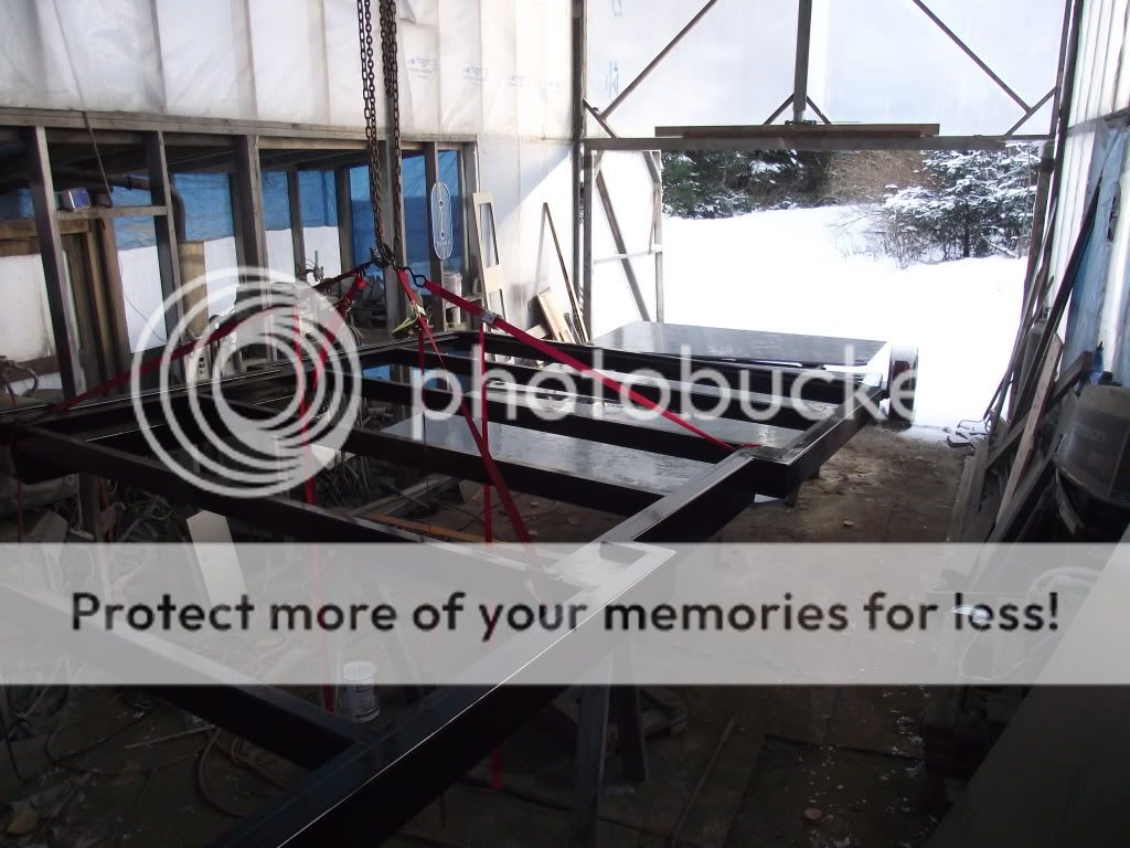

i just painted the quad trailer i'm building in the tarp shed....it's -3*c.snow on the ground.i had to use a torch to melt the ice off the metal first.

Gwaii, I was just gonna ask you about the progress on the trailer you started to build about 5 pages ago :icon_rofl: Looking good so far :icon_thumby:

ya,it's getting there....i've been in no rush with it.should be setting it on the axle tomorrow.i've had a bunch of other emergencies around town keeping me busy-seems those never end.
What type of axle will you be using under it?? 8 lug torsion spring type??

5 lug torsion spring...what he had was a car dolly that he wanted a deck set onto.it'll hold three quads,i told him not to load it too much beyond that.....no big loads of firewood.

In all actuality it has been floating around 0*C here all week. 50*F is just what the weather man is saying for this week. I don't think it ever quite got there today maybe it will tomorrow. Once the average temps around here got close to 50*F I couldn't get paint to stick right to anything, much less cure properly. So if you don't mind my asking what's your secret there. I'm guessing it has to do with heating your tarp shed, but at the moment I don't have that option.
no way to keep heat in the shed,it gets out faster than i can get it in.
i've found moisture to be a bigger problem than temperature...and for this sub-zero temps actually work better.i use a good quality urethane with a hardener,and at low temps it takes a lot longer to set properly,but if the metal is dry and clean when i spray it works fine.wipe down the metal with a good solvent-in low temps i use acetone,it picks up the bit of moisture still clinging on.also,make sure the metal is just a little warmer than the air around it-this will keep condensation from settling on it again.i start with an acid etch primer,urethane primer over that,then spray the topcoat.in low temps it can take 1 1/2-2 days for it to cure,so patience is needed.
