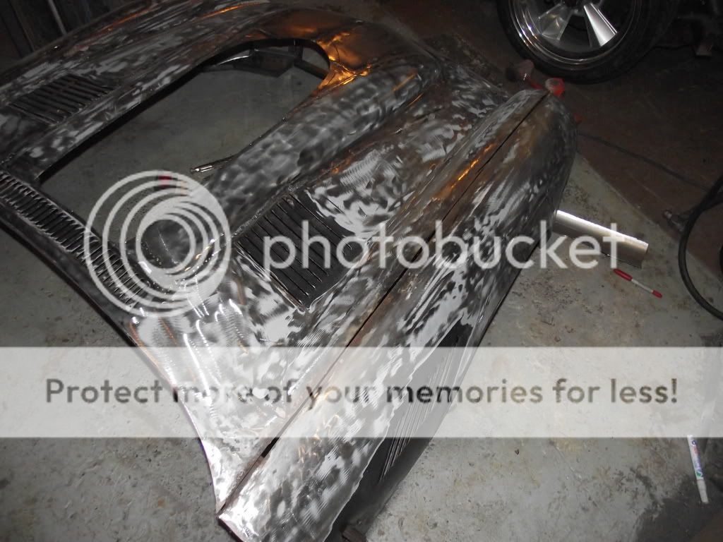

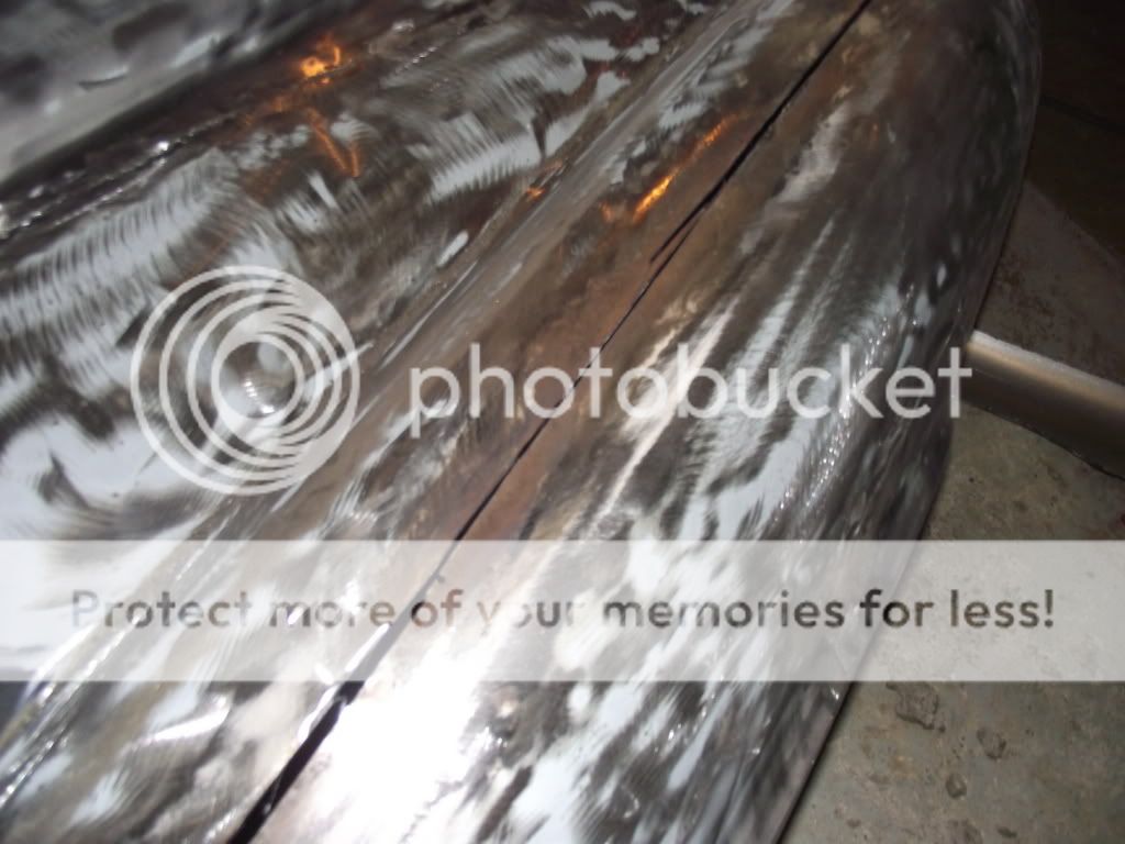

i cut the pinch welds from the hood....this is going to be a bigger job than i had originally figured on,because of my old friend rusty.
what looks like simple surface rust here is actually a drastic thinning of the base metal,even perforation,so i can't just weld the cuts together.what i need to do now is cut about a 1 1/2'' wide section out of the top of the fender and weld in new metal,more than doubling the work i was expecting in this area.

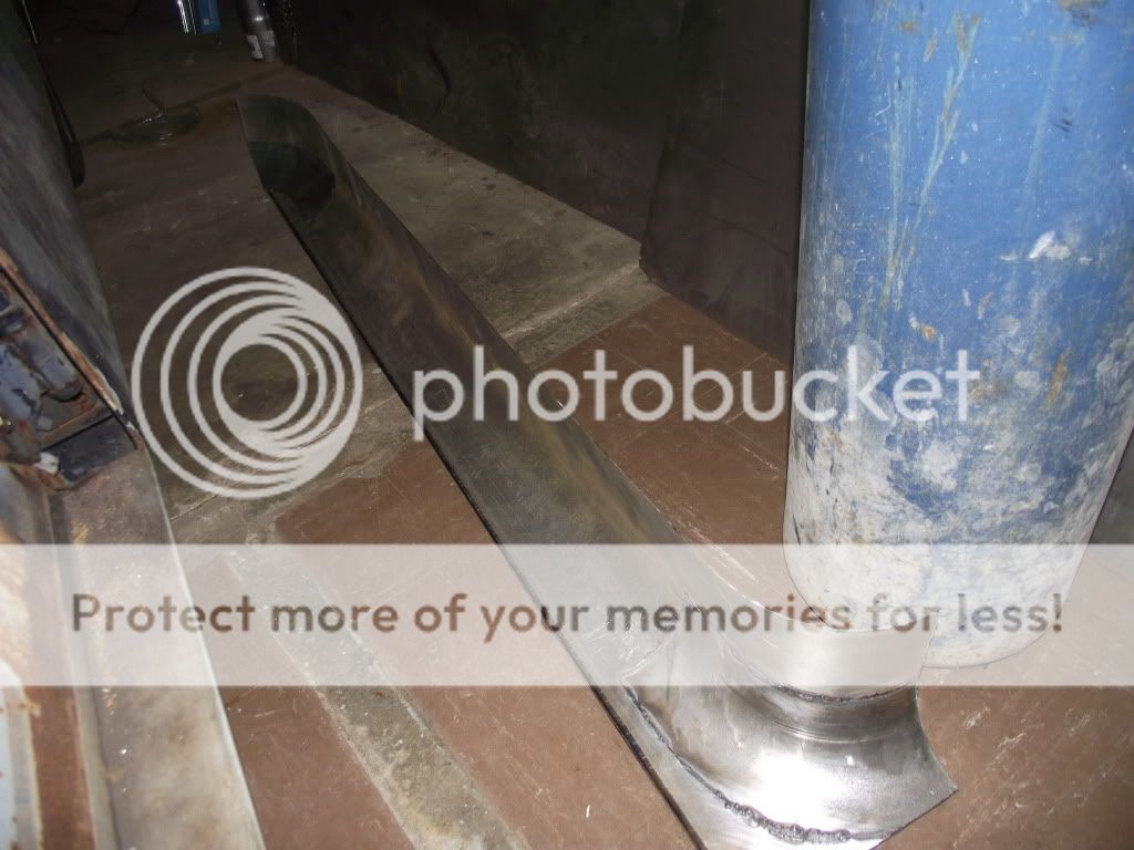

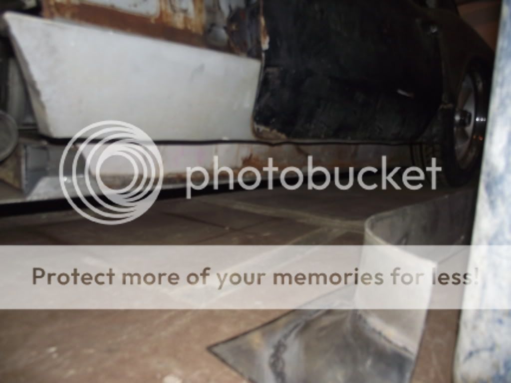

i got the left side rocker insert built,but not yet installed.getting these things to fit right is several hours a side,it turns out,but that's all part of the game.
i've got the metal rough cut from the rocker area to get on with the fitting,so i'm on the right track.

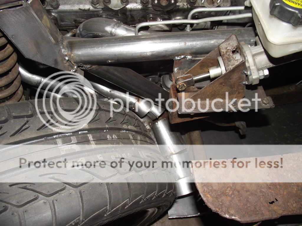

something that i really need to get on with is finishing the left header....it's close,but i need to brace all the sections so i can pull it from the motor without it losing it's shape,then i can get the secondaries and collector done.at that point i can fire up the motor again and see what it sounds like with the sidepipes hooked up.
