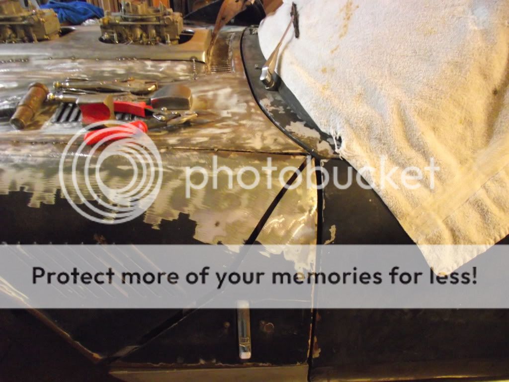

some other work i've been putting off doing on the hood is getting the back edge lined up.the seam at the door had about a 3/4'' gap-the hood couldn't go back as the line across the cowl was good,and the door was in the right spot,so i figured the best bet was to cut off this corner and move the whole thing back.
for both sides this adds up to almost another 8' of welding.

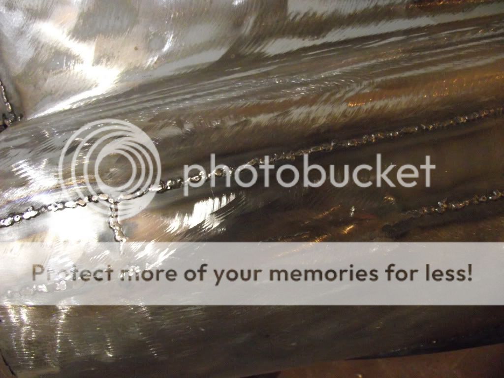

something i thought i'd throw in is how a weld should look when ground out.if everything is fitted properly and welded right,the seam should all but dissappear when ground.
