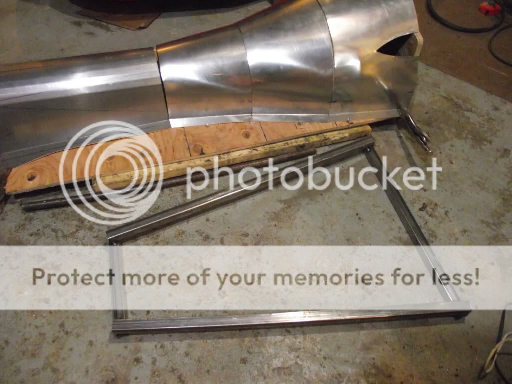

i tossed together a quick welding jig from 1x1 tubing to assemble the tunnel sections.for what i feel should be obvious reasons,welding on the wood buck is not generally considered a good idea.the parts will be clamped to this frame to weld them together,and this will hold everything in line so it still fits after i'm done.

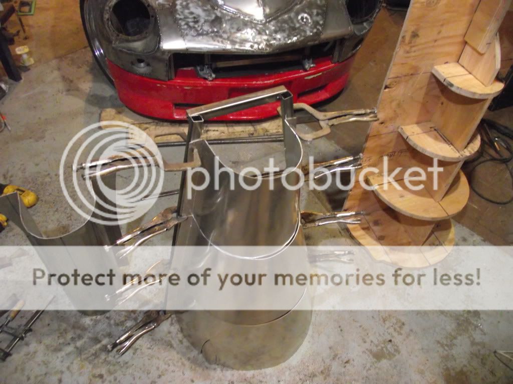

actually,catching the wood on fire is the least of the worries in this case.with tig welding,the material gets heated up before the filler is introduced to complete the weld.if there's wood on the backside,when it heats up it outgasses hydrocarbons.....and that doesn't do the weld any good(actually,it makes a huge mess-ask me how i know:icon_twisted:)so while it's great in that it's quick and cheap to work with for bucks and forms,welding on it is not a good idea.mig welding steel on a wood form is not as bad,but still can cause problems.
so,got the pieces ready for welding....
some may be wondering why i didn't put the end section on this jig-it's the driveshaft access and will be a removeable panel seperate from the trans tunnel.
once everything is welded it will be ground and sanded like the wheel tubs to look like it was formed in one piece.then i'll cover it in upholstery so no one can ever see it:D
