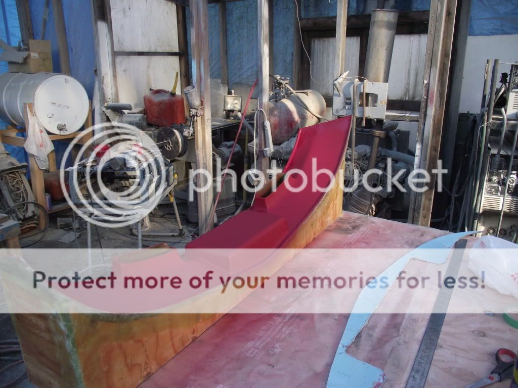

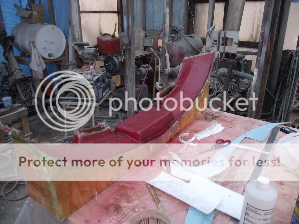

there's two key types of urethane foam....insulation boards,which are the yellow foam boards with a black paper coating on each side,or the stuff in spray cans,such as mono foam.shaping is easilly done with sandpaper and hacksaw blades.this is the way i made the forms for the headlight covers.
in the meantime,got the gelcoat on the mold.
i went with red so scratches in the paint won't be as visible.
and two layers of 2oz matt for the layup.
it should be good to pull up by this evening.
