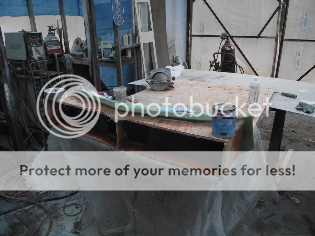

started cutting plywood for the bracing.this is just 1/2'' sheathing.notice that i've put the mold back over the plug.while it appears that the resin is fully set,it isn't.if it isn't held at this point it can warp and then everything you've done till now is wasted time and material.

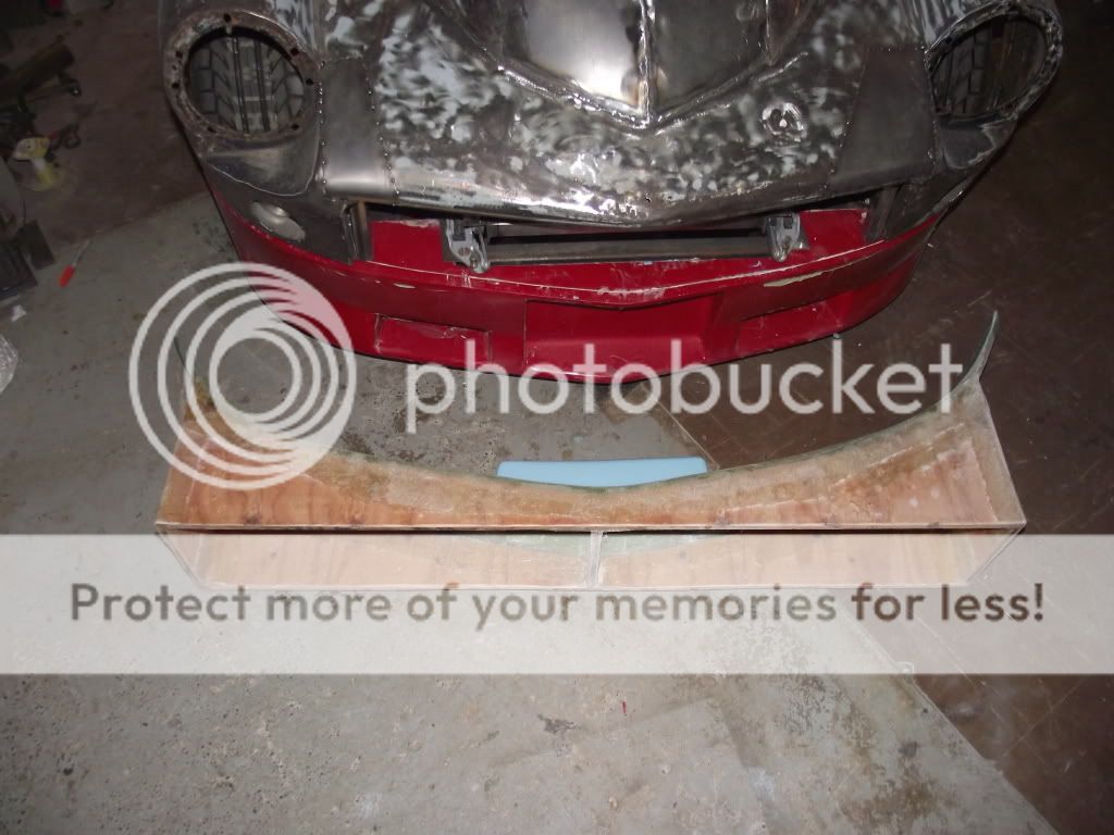

getting the bracing bonded to the mold.the bracing serves two functions-it holds the shape of the mold stable,but it also becomes a base so the mold sits steady while in use.

the bonding isn't too fancy-i just use strips about 3-4'' wide to put it all together.when the resin sets enough,i'll flip it over and do the other side.then it's just the final trimming and cleanup,and it's ready for use.

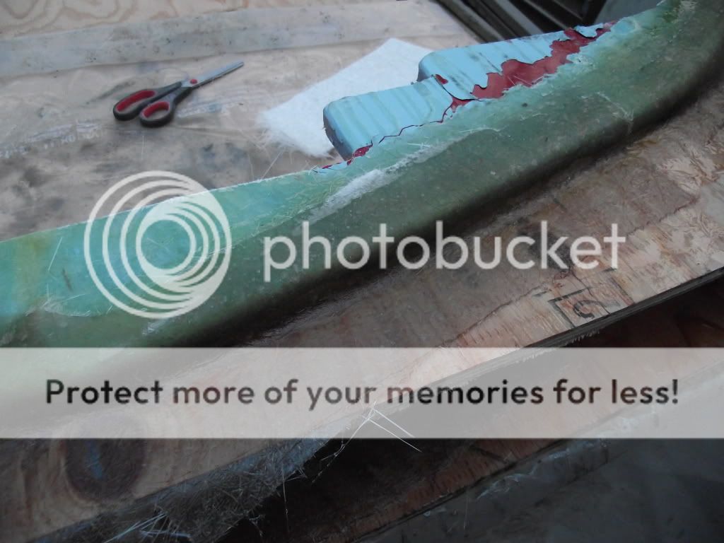

and that's the mold ready to use.you'll notice that the top and bottom plates have been trimmed back.the top plate will be added after as it would be too hard to roll out the glass in the space between the licence plate recess and the plate.the bottom plate is unneeded.
i also decided not to fix those wrinkles on the end...the marks left by them on the finished part will be easier to fix than the mold.

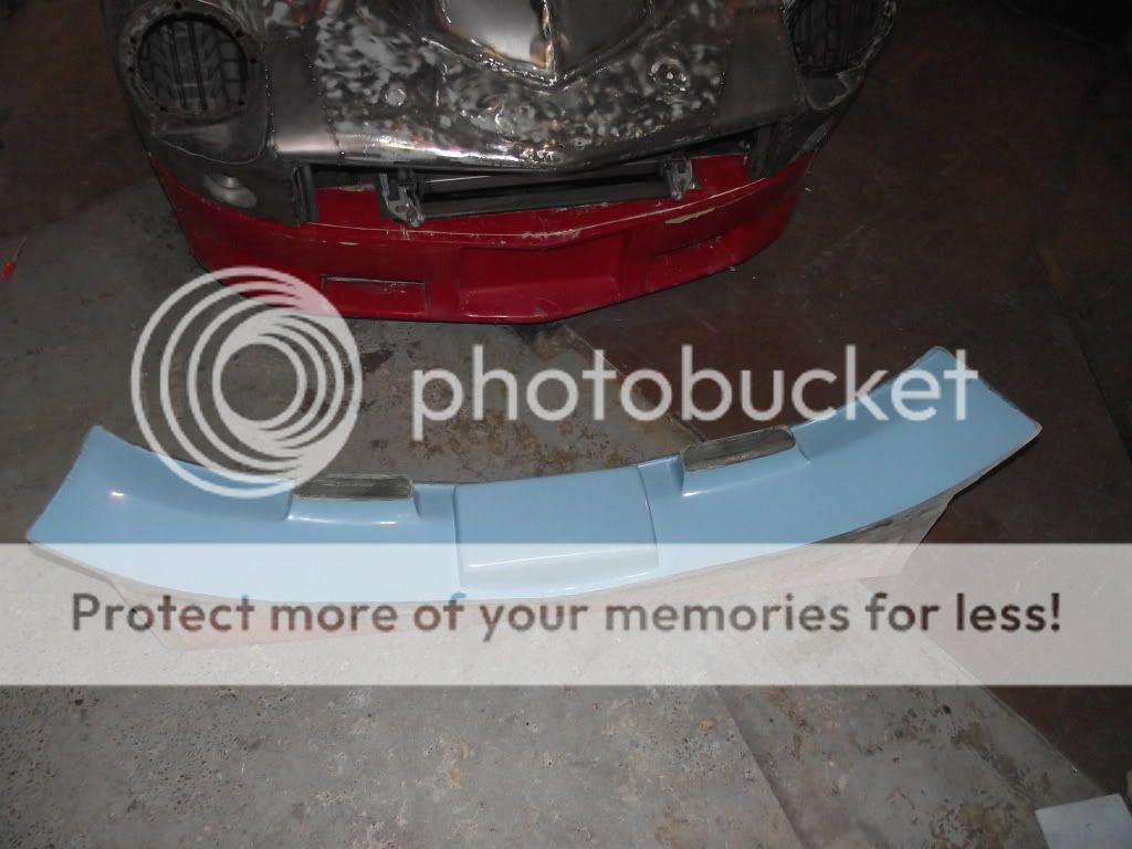

here's how the bracing looks when done.the mold sits steady now,and will be easy to use.i'll put some pva on it today,and spray gellcoat tomorrow morning.by tomorrow night i should have my first part from it.
