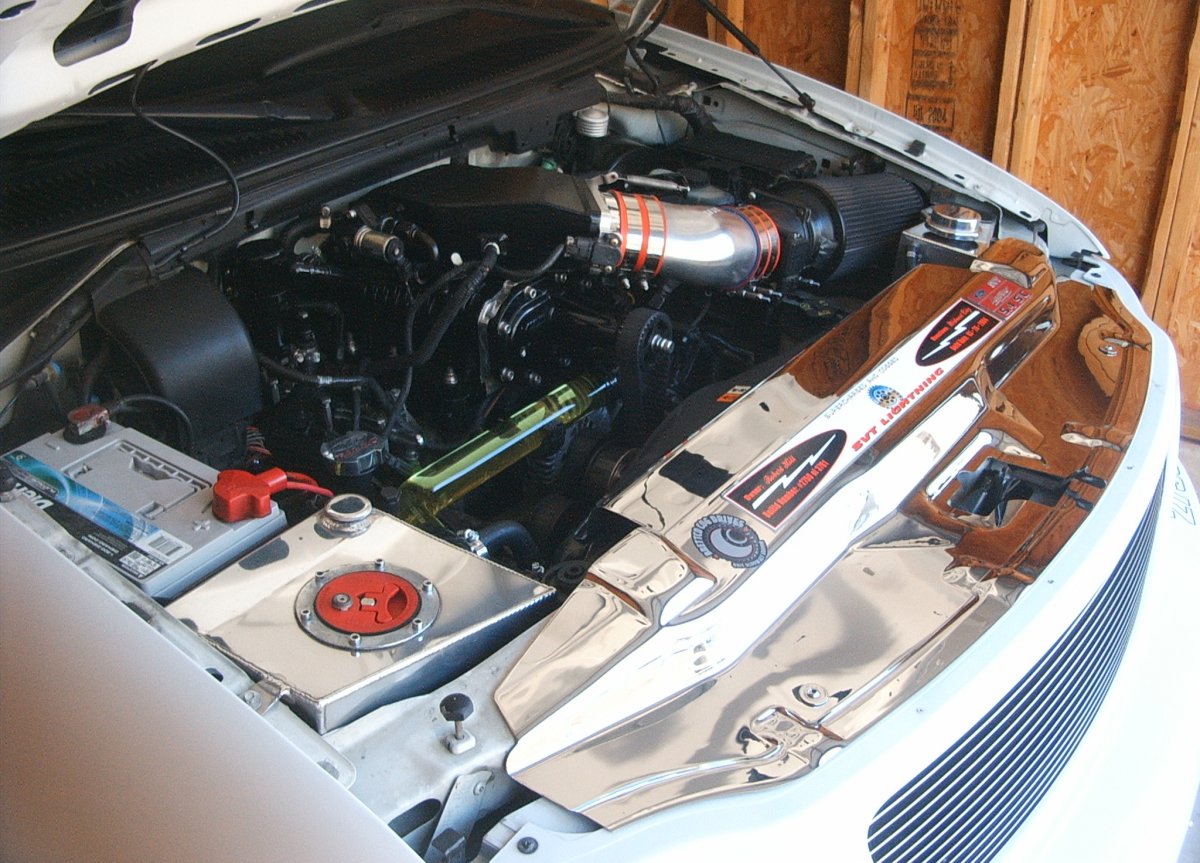

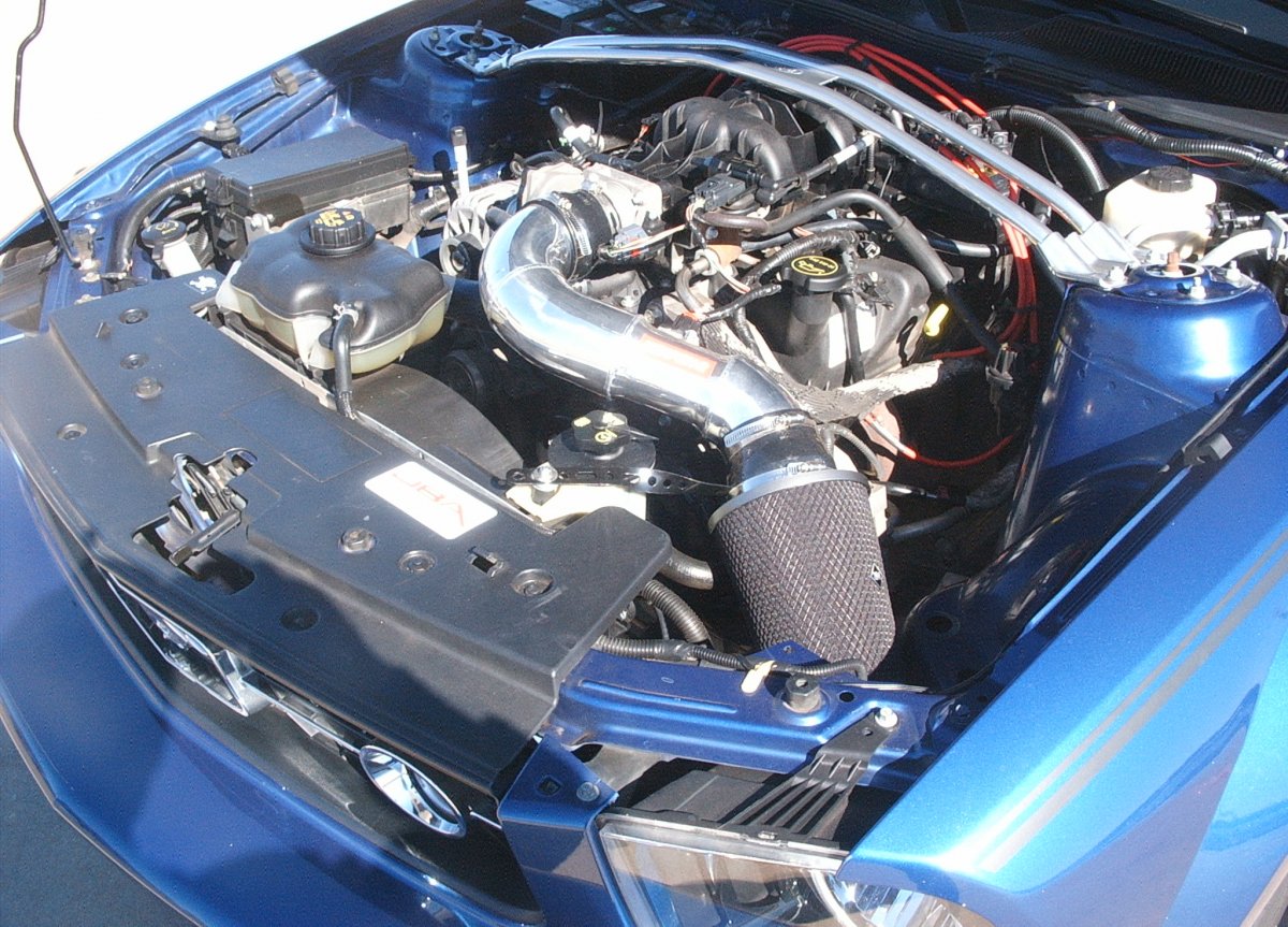

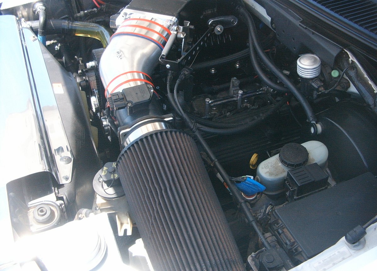

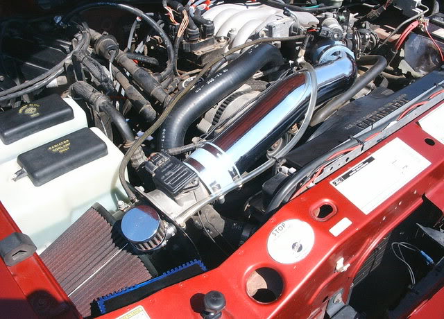

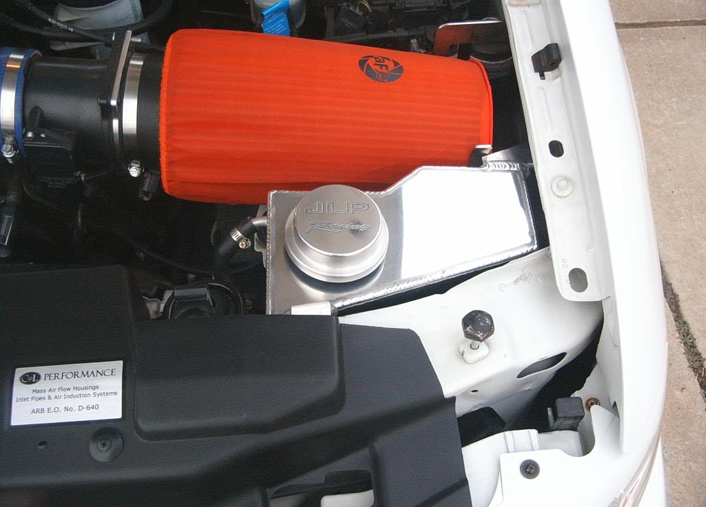

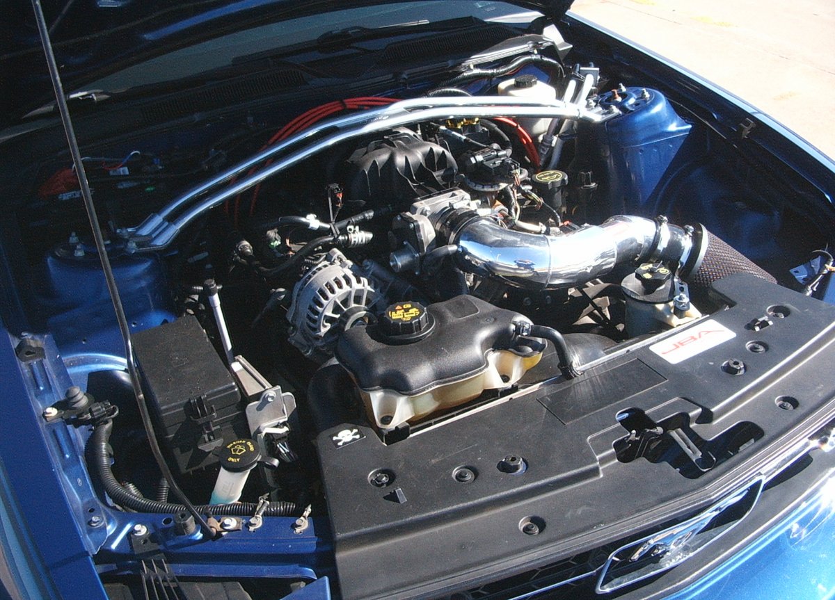

The reason most CAIs make more noise is they have a larger tube from the throttle body to the MAF. The MAC intake on my Ranger is noisy as f*ck, I hear it over the muffler less exhaust I have. It hisses real loud at idle, and has a deep throaty roar when the throttle is mashed. The intake on my Lightning is loud as f*ck, it lets out more supercharger noise than the stock EPA intake muffler airbox ever did. I just put a WeaponR intake on my Mustang. With a still stock exhaust, the intake is all I can hear.
By the way, all three have a hose running from behind the grill directing cool air up into the area the filter occupies. The WeaponR on the Mustang came with it, the one on my Ranger and Lightning are improvised.
On the 3.0 Ranger, the stock intake tube is pinched down to around 1.5 inches. Yet the TB and MAF are three inches. The stainless steel MAC tube maintains the three inches all the way across. Which is the reason you didn't really notice any change. Just out of curiosity, I tried putting the stock tube on, but leaving the open filter. Sucked ass big time. Ran just like stock. Put the big steel tube on and tossed all of the stock components in the round-open-top-file. Same with the Lightning and Mustang.
And when I buy a vehicle, the very first thing I do is change the intake. Every time. Without fail. In the Lightning world, you will be hard pressed to find one with the stock EPA intake muffler airbox. Every one of them will have an open filter CAI. The only ones that keep the stock one are those who desire their truck to remain stock. Anyone going for performance changes it out ASAP.
I even change them on my bikes. The B-King, you can't see it and all I've done is put a K & N filter in the stock location. But ran two tubes from the stock location to the front of the bike for cold air intake. The M109R, the two huge filters hang off the side of the bike, so they get plenty of cold air.

Never had those problems with mine. I've never cleaned the MAF on my Ranger, and that intake has been on it since 2002. I clean and re-oil the filters yearly. The Lightning has had that intake since I bought it in 2009. So stop spreading false facts. I use Simple Green to clean the filters and good old K & N oil to oil them. Just don't over oil them. That's the reason that MAFs get oily. Most people have a tendency to think "More is better." It's not in this case. One pass, very lightly applied, good to go.
You like your EPA mandated intake muffler, you can keep your EPA mandated noise muffler. They are there so the vehicle can pass noise emissions in a closed booth. If you're like me, and like the sound of intake noise, you got to do it. I love intake noise. As said above, my Stang has the stock exhaust system (for now, not much longer), and after I changed the intake to that beautiful WeaponR, it roars now when out and about. I love it. It's going to go really good with a new exhaust system. Just haven't decided which one as of yet.
I recently had the intake off on my Lightning, for some supercharger maintenance. You see that beautiful aluminum elbow, which replaced the crinkly black rubber POS? Not one drop of oil inside it. Totally clean.
