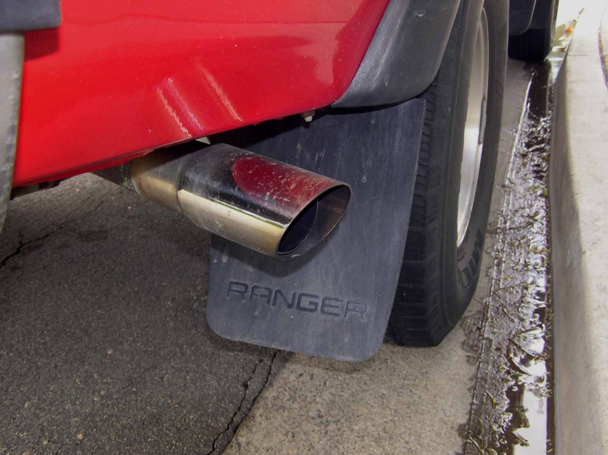

Does anyone have a few pictures of a Gibson single (behind tire) installed on a 93 or newer truck? I'm curious if the tailpipe is long enough to make it out from under the bed without the chrome tip bolted on.
The tail pipe is long enough without the chrome tip. I used to remove the chrome tip when I went off-road to keep it from getting damaged. I will take pictures later for you. It is raining right now.

Awesome! I hate bolt on tips, so this is good news
Here you go. You can see the end of the tail pipe inside the chrome tip. Actually, it is a polished stainless steel tip, not chrome. It has held up very well over 21 years, but it is a little dirty after driving in the rain..

Perfect! This is exactly what I needed to see. You have had the same exhaust under there for over 20 years? That's good to hear too.lol I'm tired of aluminized junk lasting only a year two under my daily. Figured I'd bite the bullet and buy something stainless this time. You know.....nothing like putting a brand new stainless exhaust under a truck with 300K on the odometer.
