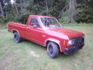

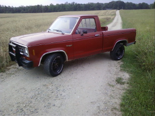

I got ahold of a set of used set of tires to go on my truck an i was wondering if they will fit in my wheel well with no problem, the tire size is 225/70/14, will these fit under my truck w/o a lift.i got the set for 150.00 bucks would yall say its worth it. I was told it would be a tight squeeze I was told they came off a ranger but they look like 4x4 wheels thall fit on my stock rims.:headbang:

I ran 235/75r15s on the back of my 2wd 1st gen for a while. They're bigger and didnt rub. I would say you have a good chance of them fitting, but every truck is a little different.
I have 30x9.5xR15's on my truck. They're stuffed but I think they work just fine.
the wheels

I have P225/75/R15's on my ranger and they fit fine in the back, but the front is tight and I had to cut the inside of my fenders a bit to keep them from rubbing when going over bumps.
