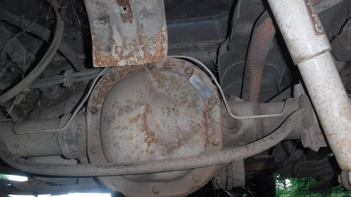

The Explorer one has a 10 bolt cover and I think that's the heavy one. Also it's a 3.73, same as my Ranger so it won't affect my mileage either will it?
