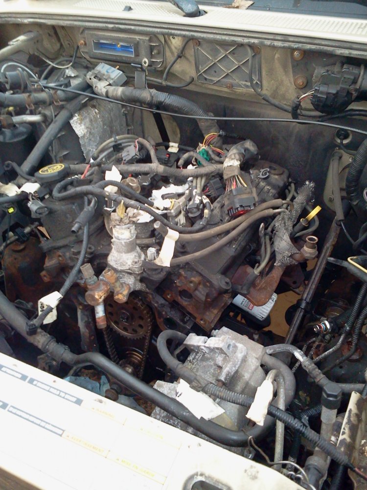

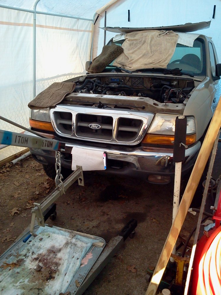

takes a while to get at everything now. sure wish I had a lift.
we've had this Ranger for 20 years, time to show it some love.
tomorrow I pull the engine for some tinkerin'
44039
hope I found all the connectors 'n stuff
44040
about half way thru a front timing cover I found a bunch of other stuff.
screw it, the engines coming out.

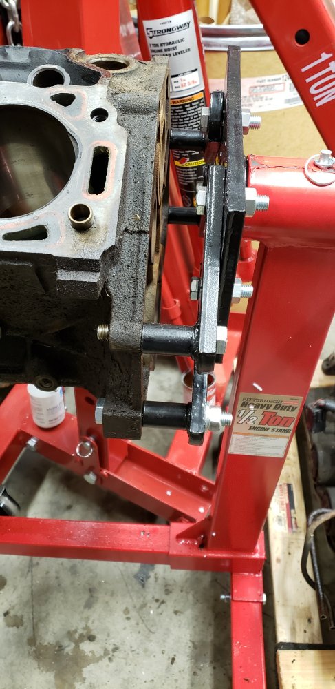

If that's the 3.0, to put it in the Harbor Freight 1/2 ton engine stand, I used;
Two M12x75mm bolts (upper) and
Two M12 x 100mm bolts with nuts and washers (lower)
The transmission bolts won't do the job.
my arms are longer, 120mm for the lower thru bolts w/ nuts, same 120 at the top with 5/8 nuts to take up the excess length.
