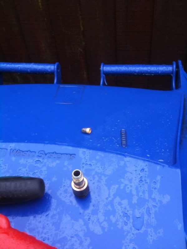

This is what you should have out

I've been working on diesels for almost 15 years. Its very common to find these little screens on diesels. Its also very common for people to NEVER clean them, mainly because most dont know that they are there. Then again, most people dont know that diesels Rangers existed. I've seen people have pumps rebuilt, then bitch at the rebuilder for not doing a good job, over that filter!!
I was looking at the pictures going wtf, I've never seen that engine, then realized the master cylinder on the wrong side.
