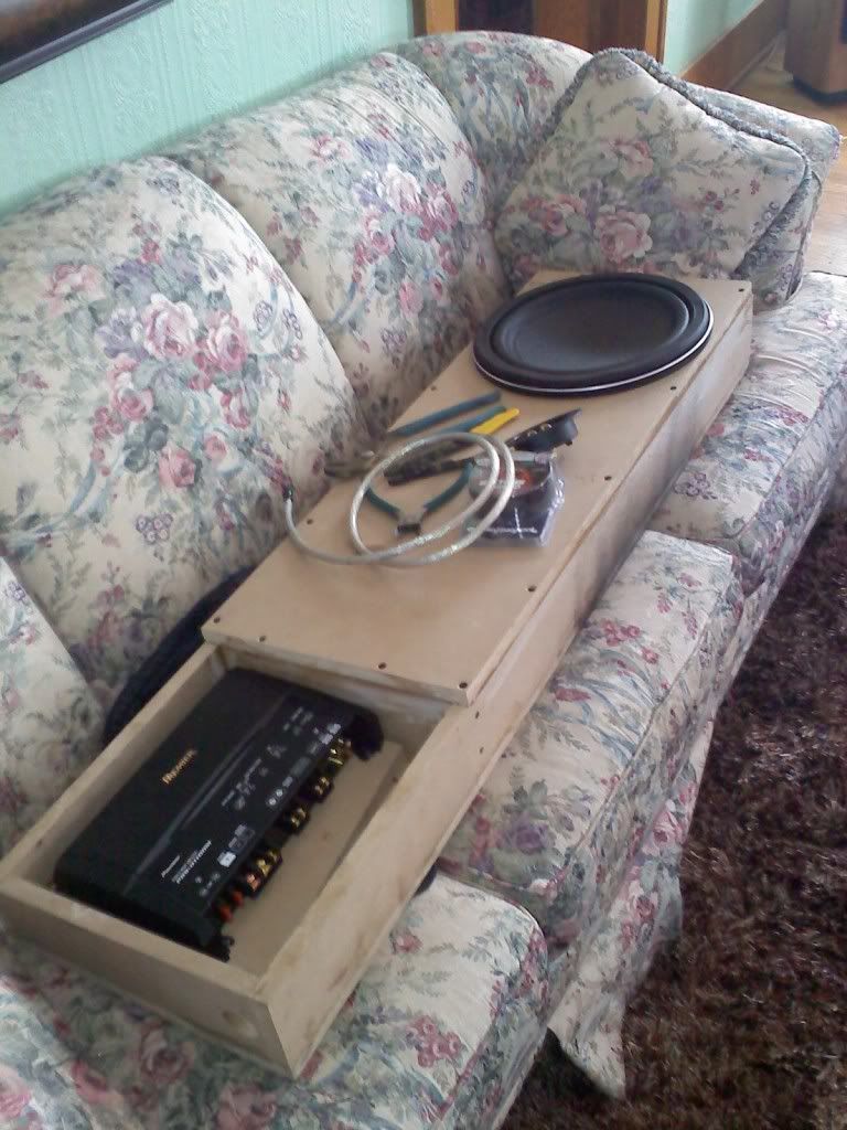

another quick question : do i need a bead of silicon to mount my sub? the box should be pretty much exactly air tight already.
you dont need the silicon.

got the amp mounted
got half of the screw holes drilled for the sub and the drill is out of power (of course i can't find the battery charger... one of my dad's legacies around here...)
