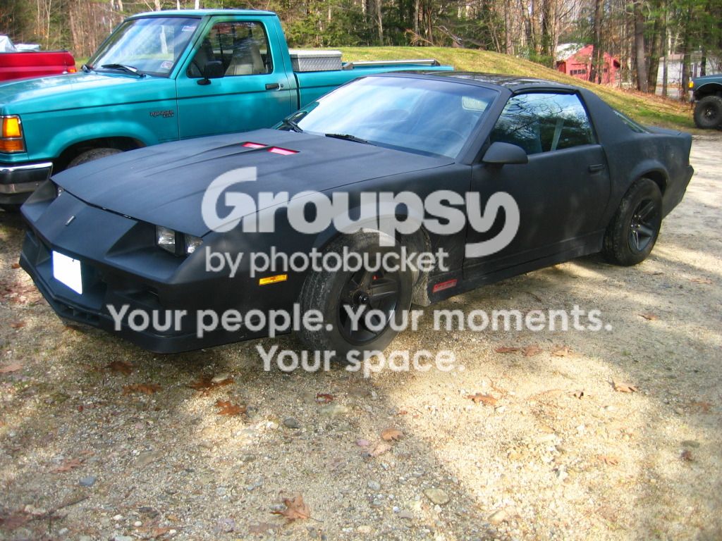

wow i have been slacking defiantly need 2 update and get back 2 building the ranger. so reason y i haven't done much 2 the ranger is cause i bought a 83 camaro for $300, it had a crossfire injected 305 that wasn't wired up and only had a water pump and no radiator no interior bunch of stuff missing, it had a 700r4 automatic and needed paint so i swapped in a 28 spline 10 bolt, welded the rear swapped in a 5spd t5, kicked the old crossfire injection in the woods and slapped on a edelbrock intake and 600 carb and did a little wiring, external fuel pump, radiator, alternator, other stuff and painted it black, long tube headers true duals and dual flow master super 10's and 3 1/2in chrome tips (sounds amazing) and is now my dd. still a blast to drive even though its a 305 and it gets around 15 mpg and burns tire all day, i have the flaps on the hood set up so i can open them with a switch inside
