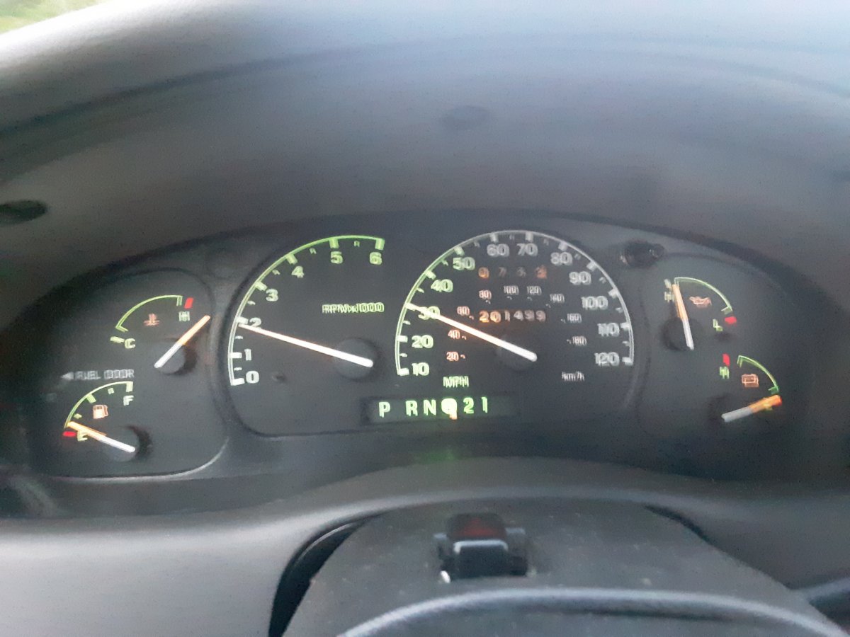

Most of the time my gauges work fine. Why would my gauges do this sometimes? If I cycle the key on off several times the gauges will start working again
since several things are affected I would go for loose connections or grounds. don't just "look" at the connections, unplug and replug several times.
