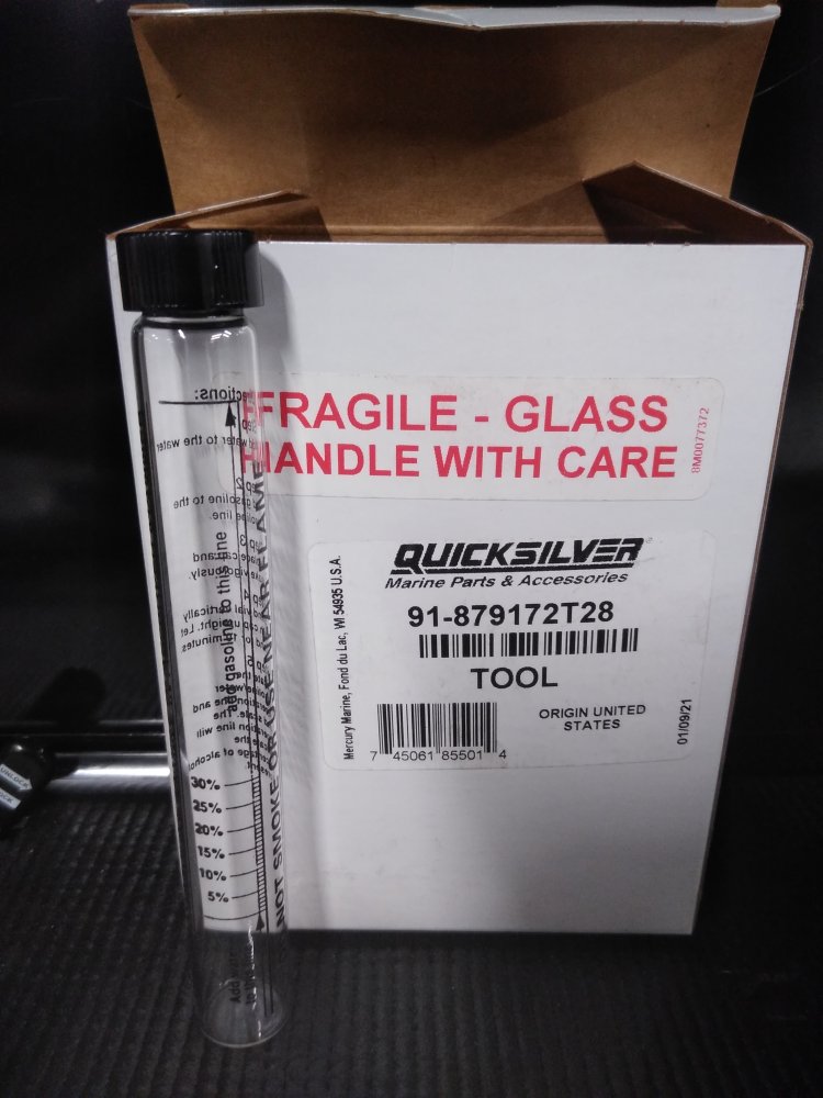

I wonder if all states will be affected? I may have to start testing all of my fuel. There are testers that will indicate the % of ethanol in gas. Ethanol is good for the repair business. I don't have any problem using E10 in a vehicle I use all the time, but no way in something that sits between use.
