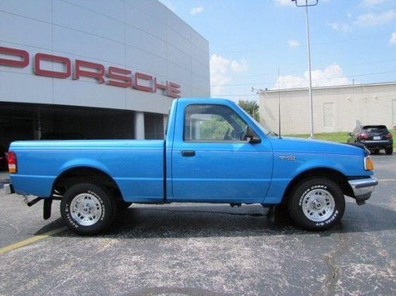

Haha.....I have the same color paint you do with the pinkish/purpleish an blue pinstripe like yours. My mechanic buddy makes fun of the striping, says it looks kinda queer to him. I told'em to talk to the guy at ford that come up with that combo of colors if he didn't like it......
Wish I had enough striping to redo my pass. door. The rest of the striping an paint is perfect.
